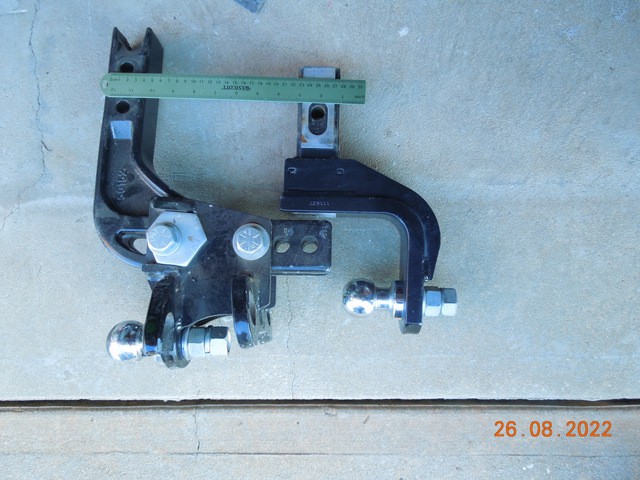

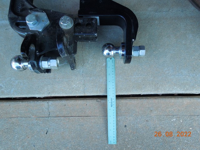

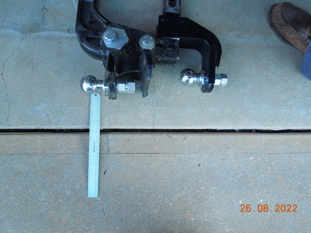

So it can be seen that wdh is 50mm longer than standard in my case LC 200. Also from rear of axle housing to rear of factory towbar receiver is 1100mm + - a smidge.
As Greg says, it's going nowhere. Seems some do not, cannot and will not understand simple physics. Sad. Cheers

Craig1 said
01:58 PM Aug 27, 2022
Sorry, I didnt mean to open the worms, but mereley a post to show exactly the two hitch arrangements. Someone was scaling using a wooden ruler last week.
Standard Tojo hitch makes it 1300 from rear axle to centre of towball, HR wd hitch makes it 1350mm to centre.
btw my towball weight is 237kg on 18'6 pop tup with dual axle load share, set back from centre of van. Approx 90 litres of water included.

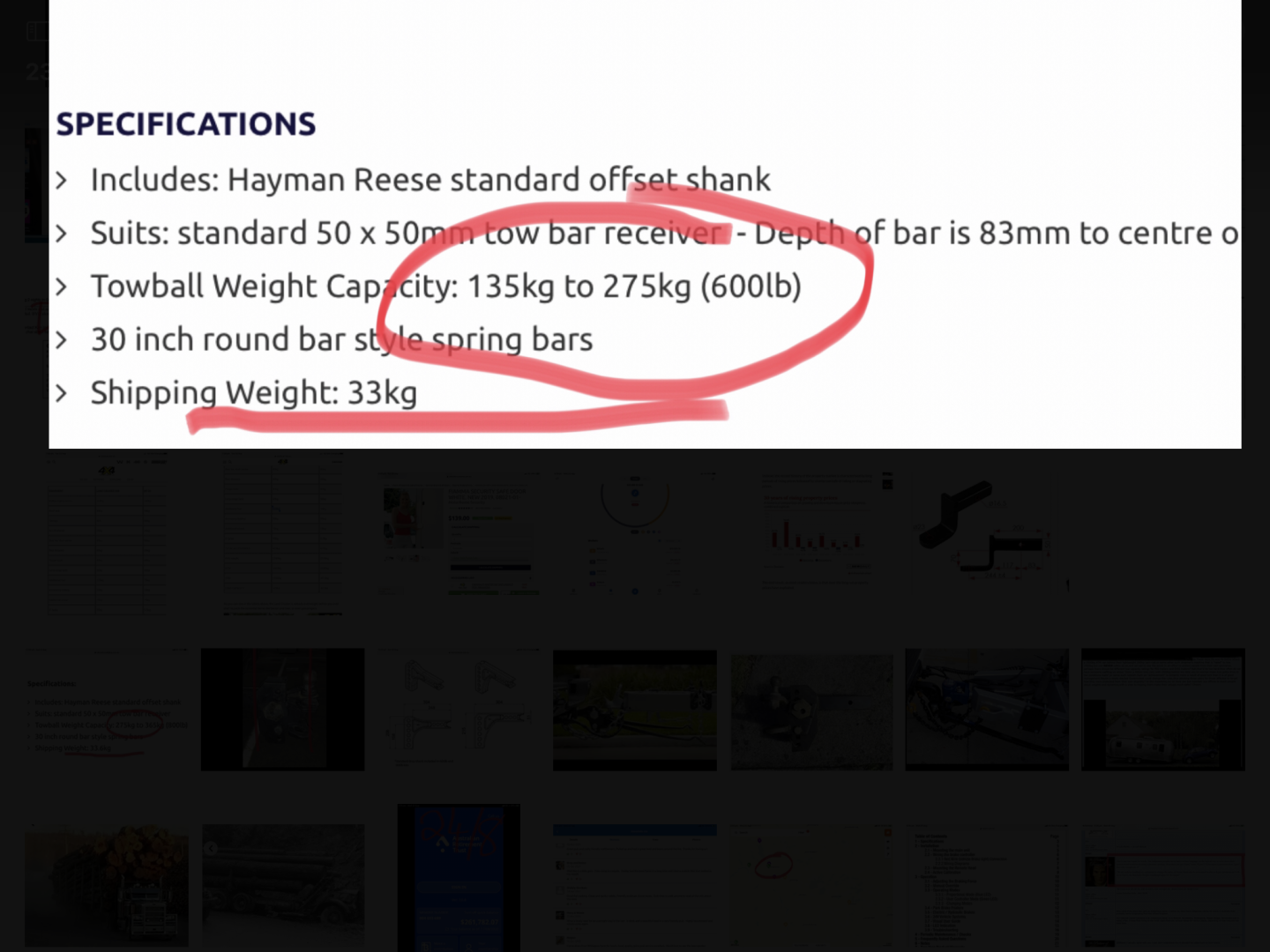

Yobarr has previously talked about 40kg additional weight for the device. From the specs, the shipping weight is 30kg, and that includes packaging and the replacement shank. After deducting that packaging and the original shank weight it's probably around 20kg. When fitted, some of that 20kg would be borne by the van wheels.
