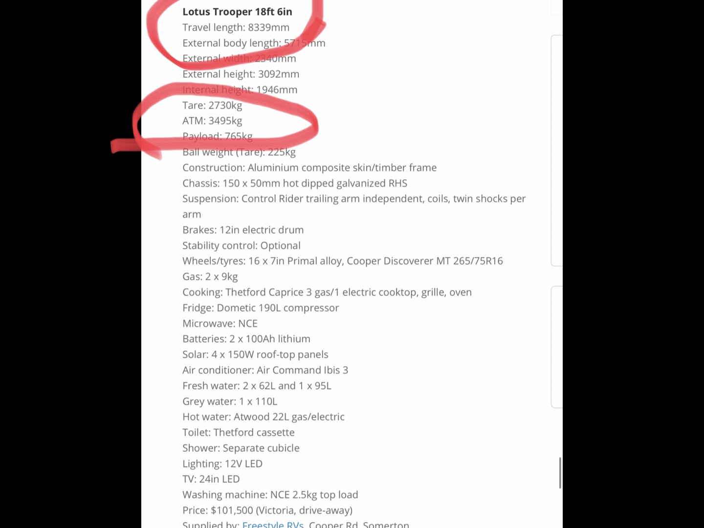

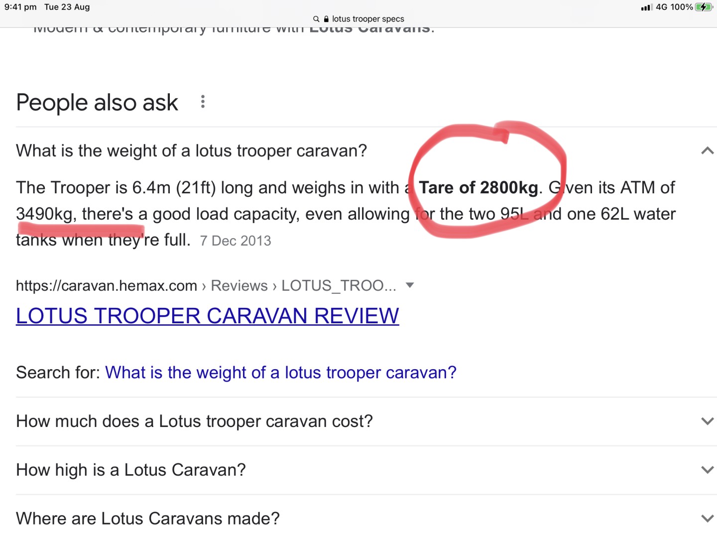

To put your mind at ease, Ivan, I will advise that the pictured car is not a decent tow vehicle, being a lightweight VDJ76R, with GVM of a miserable 3060kg and stupidly short wheelbase of 2730mm, from memory? Has a pretty good rear axle rating of 2180kg (?) though but owner shouldn't even THINK of towing anything more than a 3100kg ATM van, tops. Did you notice that the whole towhead fitting is missing from the van, there is only one safety chain (left) and that the van itself has not rolled? Little LC is waaay out of its depth here, while Ranger, Colorado, DMax are among the lightweights that would have done a better towing job because of their longer wheelbase. Please note that I'm not suggesting that ANY of these cars could safely tow that van as I believe that Lotus are quite heavy vans? Looked at one but steered away. Cheers

Ivan 01 said
09:28 PM Aug 23, 2022
yobarr wrote:
Ivan 01 wrote:
DMaxer wrote:
The driver was stung by a bee or he swerved to miss a cat.
While he was waving at an oncoming driver of another caravan.
To put your mind at ease, Ivan, I will advise that the car is nor a decent tow vehicle, being a lightweight VDJ76R, with GVM of a miserable 3000kg and stupidly short wheelbase of 2730mm, from memory? Shouldn't even THINK of towing anything more than a 3000kg ATM van. Did you notice that the whole towhead fitting is missing from the van, there is only one safety chain (left) and that the van itself has not rolled? Little LC is waaay out of its depth here, while Ranger, Colorado, DMax are among lightweights that would have done a better towing job because of their longer wheelbase. Please note that I'm not suggesting that ANY of these cars could safely tow that van as I believe that Lotus are quite heavy vans? Looked at one but steered away. Cheers.
-- Edited by yobarr on Tuesday 23rd of August 2022 09:07:52 PM
Once again Yobarr we thank you for your advice.
You have made some very valid points.
However I am surprised you neglected to tell us how unstable that combination would become on a less than perfect road surface due to the rear track of the tow vehicle being almost 4 inches narrower than the front
Yes it appears that it has broken the coupling and the safety chain has been torn from the van and is lying at the rear of the tow vehicle, while the second chain appears to have remained connected to the van but has become detached from the vehicle.
I am so surprised that the operator has adopted your advice and did not even consider a WDH. Maybe he thought he didnt need one or maybe he has been reading this forum.
I was wrong as I thought I had read somewhere that the GVM of that vehicle was 3300 kg.
If it was as you say only 3000kg then the van with an ATM of 3490kg was really stretching the friendship between the van and the car.
BTW, what is the manufacturers recommendation for the use of a WDH on this vehicle when towing a trailer of that weight (assumed).

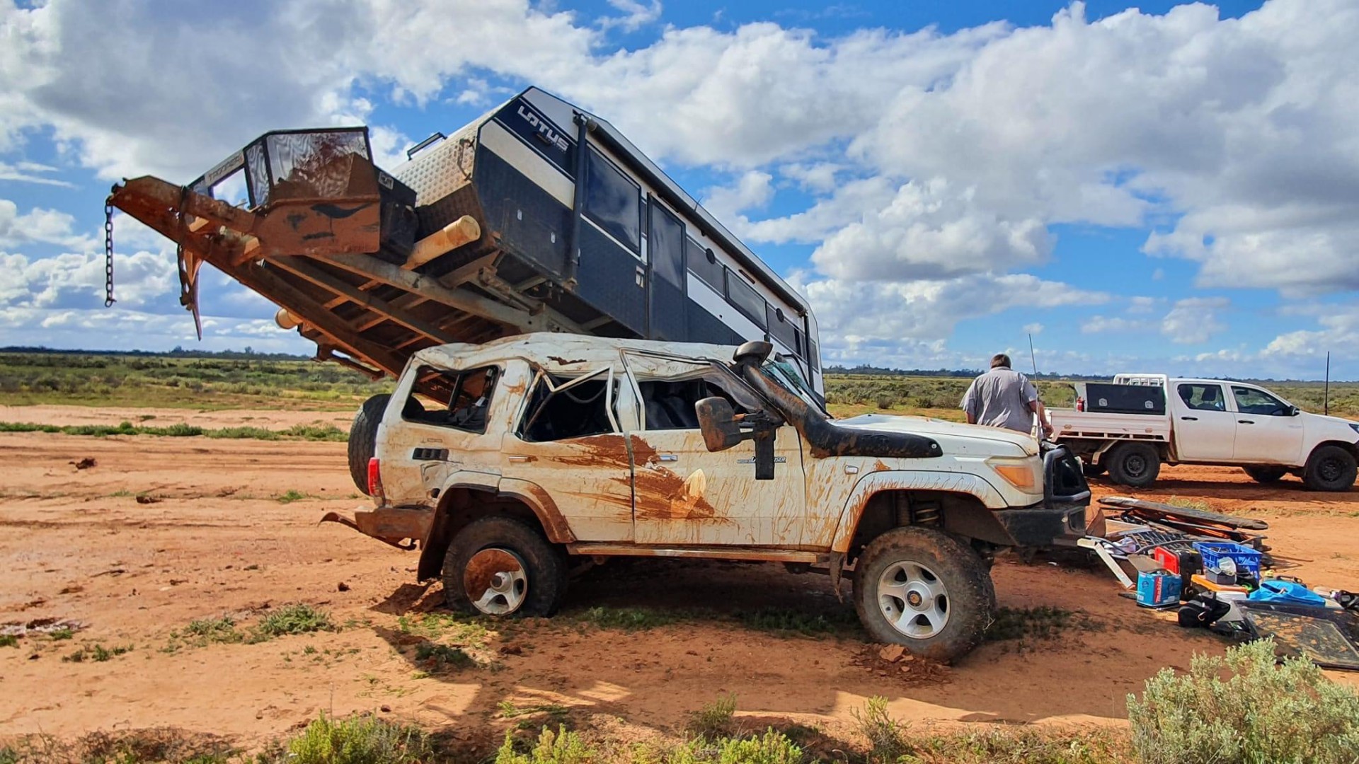

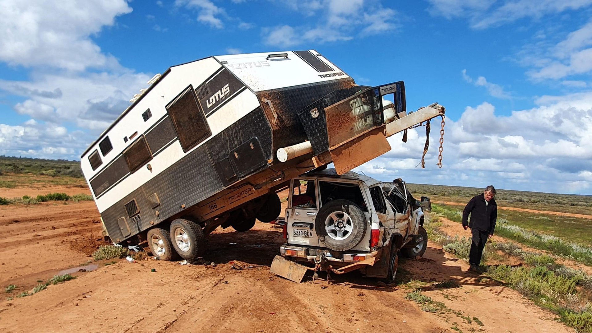

Gundog said
09:55 AM Aug 24, 2022
Just a couple of obeservations
At some stage of the event the tyre has rolled off the rim.
It appears its a DO35 coupling that has snapped or sheered off at the yoke.
The safety chain still attached to the van has the shackle intact, has it torn off the towbar, and the saftey chain still attached to the towbar looks as though its torn off the A frame.
Is this a rare event where the rotation off the tow vehicle while the caravan remains on its wheels, with the safety chains wrapping around coupling causing the yoke to sheer off from the shaft of the DO35.?

Thanks John, for pointing out my mistake. Although I am not flash at estimating van lengths, when I Googled "Lotus Trooper" the supplied details appeared. However, seems to make little difference as a couple of caravan sales places have supplied the details below for your perusal. Only someone with little understanding of dynamics would hook such a heavy van to a lightweight car that has a really short wheelbase. All the popular lightweight twin-cab utes have much longer wheelbases, and are therefore inherently more stable. The facts that I supply in good faith may not be what some may want to hear, but all I can say is "Don't shoot the messenger". Cheers
Something that I believe is often not considered by caravanners (particularly someone new to towing...)
The "high centre of gravity" of "off road" style caravans together with high clearance "off road" suspension kits fitted to many Tow vehicles generally detracts from the handling of the whole Rig at normal road speeds no matter what the surface/road conditions are like. Example - safe cornering speeds are lower (especially on undulating ,sweeping bends - of which country Australia has plenty) KB
Hi KB
You are correct.
A close look at the hitch on the car shows that it has a receiver that is set up to raise the tow ball to the height of the drawbar.
I am surprised that the caravan didnt drive itself deep into the rear doors of the Tojo.
It was probably saved by the strength of the safety chains even though they did break their mountings as the car rolled.
If it were me, I think I would rather the van roll and the car stay upright.
There has been a lot of talk regarding the basic safety of having a D0 35 but not many of us have realised that the safety chains actually work against the theory of the hitch rotating without tipping the towing vehicle.
The occupants were lucky with the female only suffering a broken finger, apart from the stupidity of the choice of mismatched vehicle and van.
The thought did come to me in as much as I wondered wether the D035 was actually a genuine unit or one that comes from China.
Surely a manufacturer of new vans would not cut corners to that extent.
It warrants a close look from the assessors.

Met a very lucky couple today. They said I could post these pictures. They rolled their car on the lindsay point road and the caravan landed ontop of the car. They walked away with a broken finger. Thanks for the help from the boys at cmv farms, legend"
Hi KB
You are correct.

Apart from anything else they're very lucky people, but unfortunately have learned a lesson the hard way. But for the grace of God, there goes you or I.
All contributing to instability of the van and rig.
The forces at play in an accident of this type are enormous and have obviously exceeded the design limits of both chain and hitch. I doubt very much whether any 3500kg hitch would have survived this.
