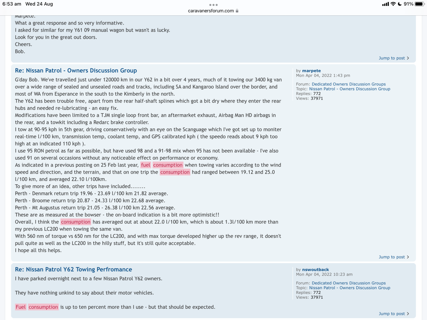

I have a Series 4 Y62 , we have just returned home from a 14858k trip towing a Complete Campsite Exodus 14 , we used 3146lts of fuel , that's about 21.2lts x 100 if Im correct . We did Lorella Springs , Gibb River Rd . We travel mostly at the speed limit + a little bit if Im to be honest we don't hold trucks , road trains up they never need to overtake us and we very rarely need to overtake them . Our total weight the day we left was 5840Kg . I have a 300kg GVM upgrade for the 62 because its very easy to exceed the max GVM especially the rear axle .

My GQ 4.2 EFI (petrol) Patrol when pulling the 2334 Kg Jayco Westport at 85/95 Km/hr uses 21L/100k.
Overall trip consumption with < 20% without van consistently returns 19.2 L/100k.
I'm happy with that.
