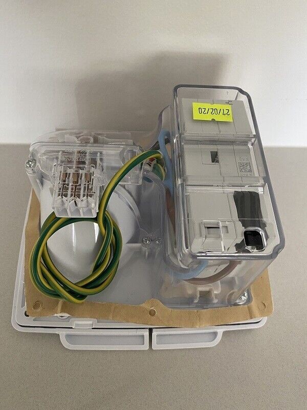

Annie and I are in the middle stages of our coaster bus conversion. We decided to use the CMS electrical system and as such have got the 15Amp inlet with RCD.
when it comes to cutting the hole in the bus to fit this unit the shape is complex and I cant think of an easy way to make a hole template for it. My mate Google has let me down too.
does anyone out there have a hole template for it?
kind regards. Grant

How about:
Photograph it
Import the photo into Photoshop (or similar)
Manipulate it to 1:1 scale
Use the drawing tools to draw an outline
Print it
Test on a piece of cardboard first

Cut a hole a bit larger in a sheet of paper. Patch up hole to match perimeter of object with sticky tape, with or without patches of paper. If you end up with layers of paper, cardboard & tape it doesn't matter. Doesn't need to look pretty. It will actually make it more solid.

Is this the one
Yes indeedy gundog thats the one

How did u do it gundog?
I just got the picture from CMS web pages, it appears it is supplied with an adheasive foam gasket, which would be easy to trace and make a template.
I have scaled things on the computer screen & traced.
