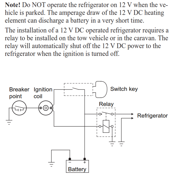

Really! Don't you have any respect for your battery. Back in the 1990s when fridges were smaller and only drew 12 A, the following was Dometic's advice.
