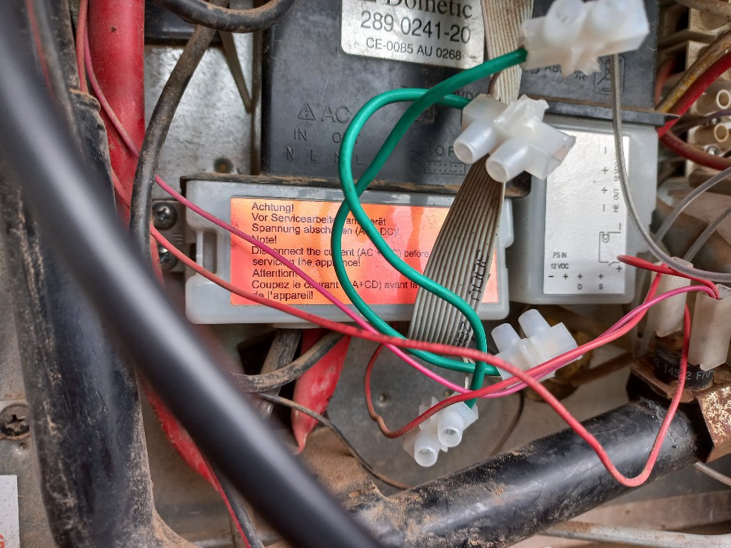

It started off with flickering lights and then it was switching from 240 to gas, temperature lights varying by themselves, powering off by itself, etc, etc. Then disaster! completely dead. No fridge and heading up north. I'm a former electronics technician so it was easy for me to check the simple things with my multimeter. All to no avail. I bought a 60litre portable fridge but they are a pia for food. Great for beer!
Well today I thought I'd dismantle the lower control panel and I spotted a flippin burnt out wire on a multi connector, see pink circle on photo. It must have been arcing to the gas ignitor HT wire. So I jumpered-out the offending two wires as a temporary measure and brill!! powers up now, and gets cold. Eureka.

FreecamperTas said
07:09 AM Jul 14, 2022
Yeah Radar. I am discusted about the wiring mess. But it works and I'll get the soldering iron and heat shrink on it when I get home. BTW, the Dometic wiring is a bit of a mess from the factory. This is what caused the problem in the first place.
Cheers Tony
