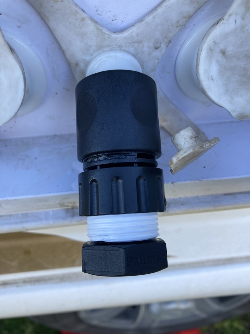

GlobalTraveller said
09:06 PM Jul 18, 2022
Thanks for all the assistance. This did the trick (see image) and allowed me to use water from the tanks with pump on. When I removed it and tried the pump I found the problem had resolved itself, for now anyway. For $5 not a bad backup to carry for Jayco van owners perhaps. Cheers. Steve
It makes my suggestion look very complicated.
Well done.
