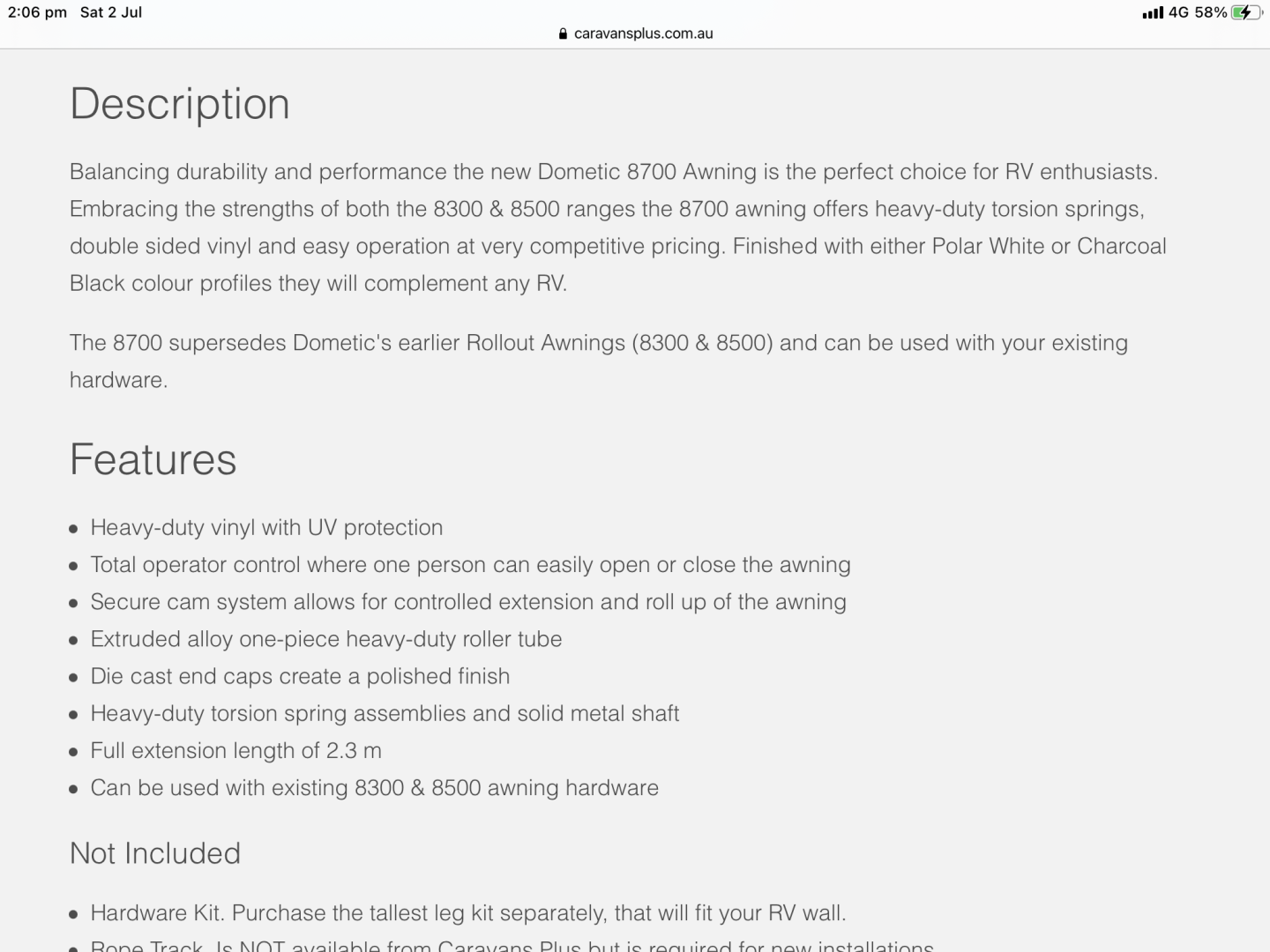

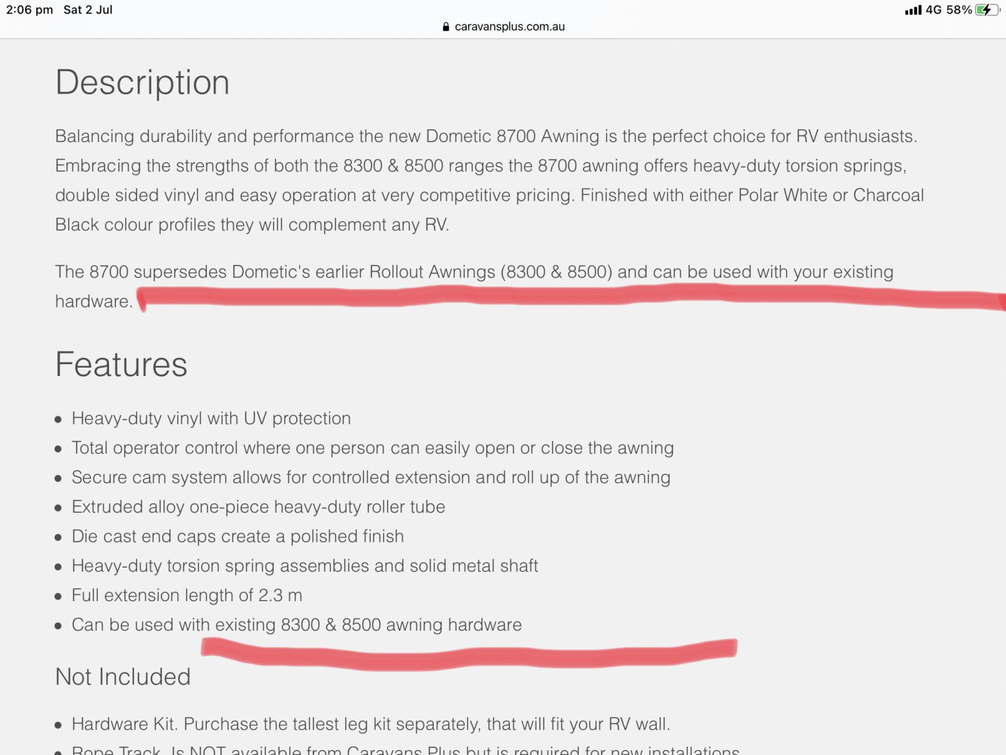

My 8300 awning has a bent roller and needs to be replaced. I was told that the 8300 is no longer made and I will need an 8700 installed.
The repair company is saying that an 8700 roller will not fit an 8300 frame and I need the whole thing replaced.
a conversation with a mate who is a supplier of trailer and caravan parts tells me the 8700 roller will fit the 8300 frame.
is there anyone around who has done this so I can have that conversation with the repairer?
Appreciate any valuable experiences.

Hi Frank. This story may put your mind at rest. Caravans Plus.
