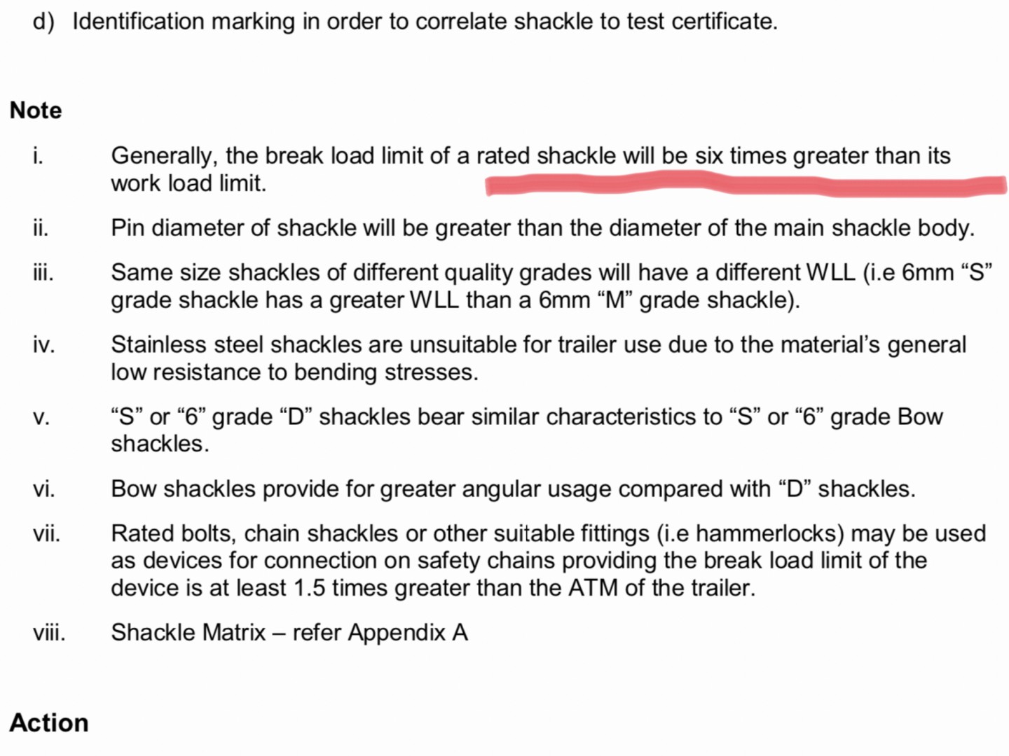

What I found interesting was that 2 1t D shackles are OK for 4t van.

Shackles are designed for lifting and rated accordingly. There is a big difference between lifting loads and possibly keeping a trailer attached. Also consider, how big a fish can be caught on 12 lb line?

Thx Barney, a good analogy.
I guess the qualified mechanical engineers do the maths and then the risk assessment.
I've always understood the loads would mostly be less than lifting but I was surprised at that a 1t D or Bow could be used for a 4t van.

For those interested in shackles and there selection.
https://www.couplemate.com.au/dee-shackle-select-correct-size/
