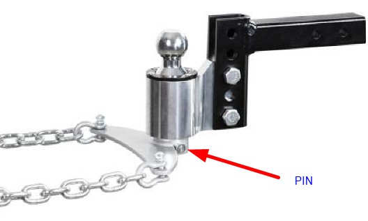

High Cupie, the ball of the tow ball is like any other tow ball, the tow ball shaft is where the friction pad is. The trailer does not turn on the tow ball
as the tow ball and trailer turn together.
But like any coupling it does swivel up and down over bumps and dips and the chains are pulling the trailer hard onto the tow ball and that is why I lube my tow ball. Hope I have explained it clearly enough.
regards Russell

I will answer the questions for Rusty.
The towball is pinned to the plate, and the chains at the end of the plate are attached to the drawbar. So those items don't move in relation to the drawbar. The ball can only swivel in it's housing which is part of the tow hitch assembly. So, as you turn, the A frame, coupling, plate and ball all rotate in relation to the hitch assembly. This is the opposite of the normal situation where the towball is fixed to the hitch.
The shaft of the ball is cone shaped and sits in a cup that fits snugly into the stainless steel housing. The more the towball load, the tighter it fits, and it is here that the anti sway friction acts. As I mentioned before, there is no way of swivelling the plate even with a heavy hammer. But remove the pin (van disconnected) and give it a whack from underneath and it easily comes apart.
As for the process of what to do if the van was disconnected in other than straight ahead, I might try BaldEd's suggestion of lining things up with the aid of a stick. But sometimes that is not feasible and you have no choice but to connect at a different angle.
I approach it differently. If the difference is small, it doesn't matter. Just leave the plate at an angle. The chain tension will still equalise. Just make sure the drawbar can't foul on the plate. If the angle is larger, one chain will be too short to fit the bush and nut on the end. Jist attach the other chain and complete the rest of the hookup. Drive off and turn a corner and that should straighten the plate sufficiently to insert the chain and tighten it.
I have never lubricated the ball or chains on mine, but it may be a good idea. The supplier did send me a small bottle of lubricant for the cone ... I think it may have been silicone. I was told to put one or two drops there if it squeaked. I did that then when I assembled it but have not touched in the last 15 - 20,000 kilometres. The friction cone is degrading a bit now, so this has been a reminder to order another one. The ball is showing signs of wear but still serviceable.
Spoon drains? I have not removed or detensioned mine for any normal roadways, driveway entrances, etc. I suppose if I needed to cross a deep one, I would just approach it at an angle. But with any WDH you do need to be aware to avoid the situations that would come close to the tow vehicle rear wheels being lifted off the ground.

Thanks AWL, your explanation made things clear for me. I didn't realise the plate at the bottom rotated as well.

Thanks AWL, your explanation made things clear for me. I didn't realise the plate at the bottom rotated as well. I have a Hayman Reese WDH and the bars usually come off before backing into a site and are refitted to go, once on a straighter path.
I never do that. Even very sharp turns, including U turns. The system just "swivels".
