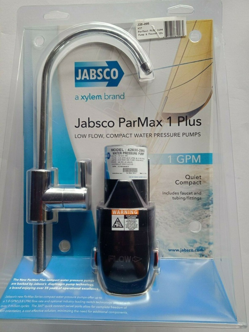

I bought a $120 pump its working fine. Yes dont buy the cheapest! I checked brand at caravan : boat store ! Then bought for less on line . Same brand with push on fittings etc. adjustable pressure . I actually turned it down . Only need enough to do the job . Rubber carpet between pump and floor for sound insulation . Screws actually loose so doesnt transfer sound, harmonics! Its pressure sensitive !! Operates when tap is turned on

Looking at installing a 12 volt water pump purely for the kitchen sink. Wanting to keep the install as simple as possible, and trouble free.
Seen this advertised, seems like a good deal....any thoughts on this brand combo unit. Steering away from the $30-$50 jobs advertised online
Thanks, the rubber base sounds like a good idea
