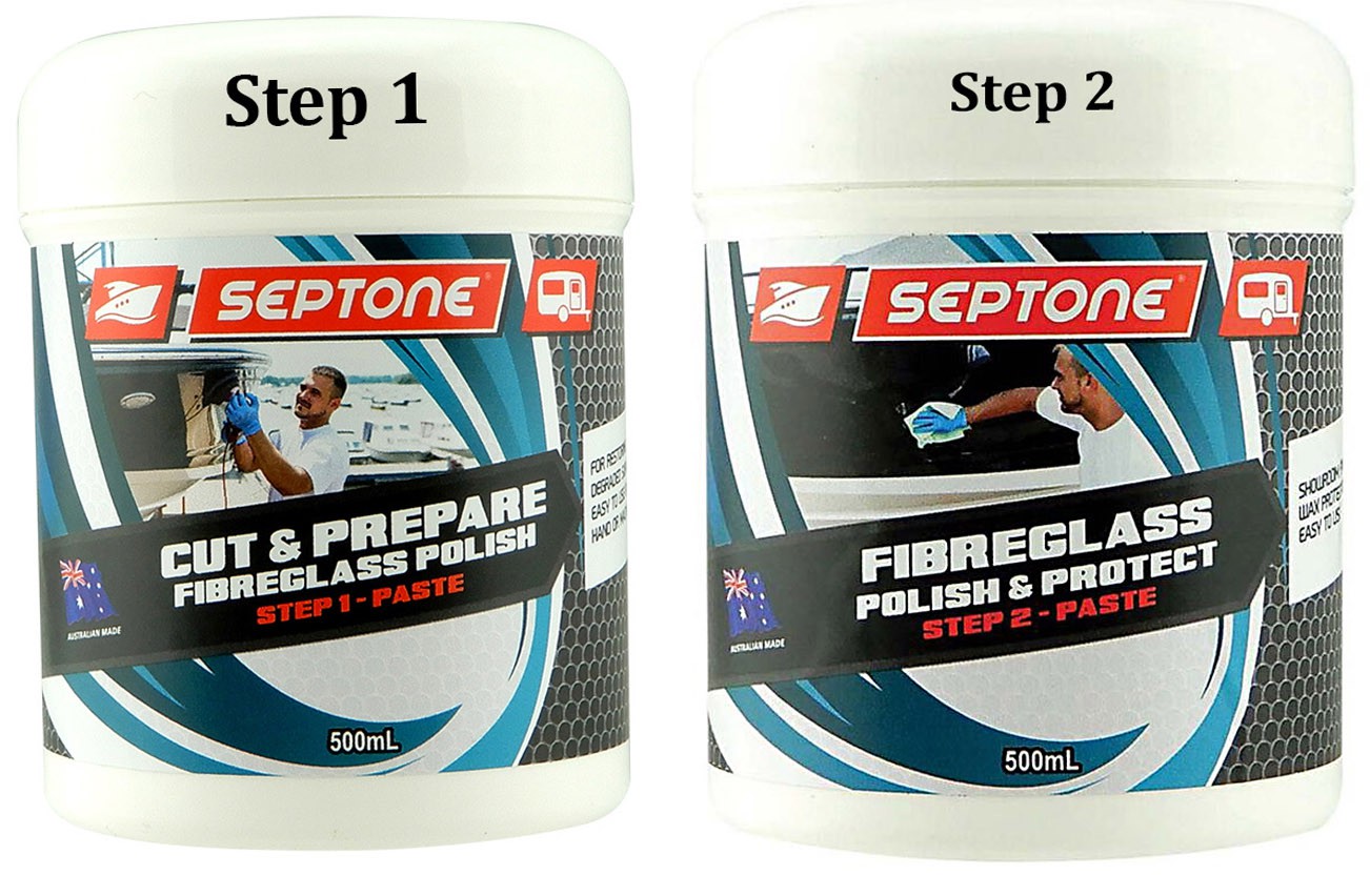

I used a twin pack, step 1 and step 2 to rejuvenate my Fibreglass Van that was looking a shabby and dry after years of UV. Worked very well, and now I just apply a little of the Step 2 polishing cream now and then. I think if you use any cutting compound you need to be carefull you dont strip off the Gelcoat. For an RV/Van in good nick just the Step 2 Polish should be a good preventative.
