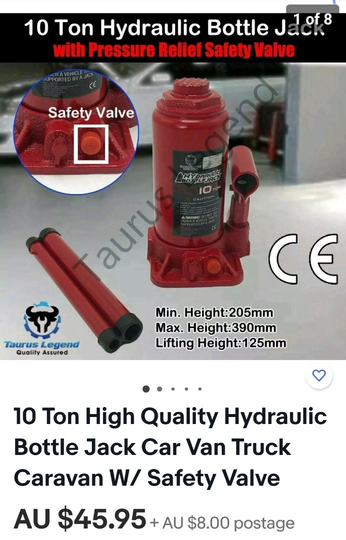

I guess you could weld "pipe" (body of a normal jockey wheel) to the jack & would t G en be clamped in place like a normal jockey.
But
I had a look at this and most hydraulic jacks seem to have about 5 or 6 inch lift. Most jockey's have more like 8 inch.
