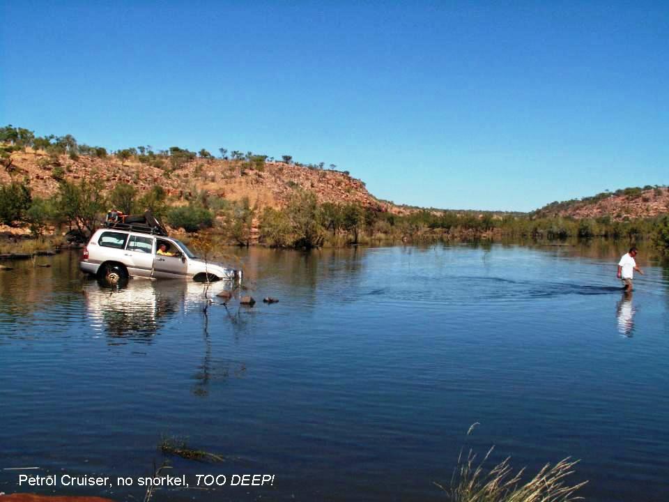

Its more about have induction high so water doesnt get sucked into engine .When crossing any water . Another benefit ? It sucks fresh cold air in away from engine bay .Often cleaner air if dusty roads ??. The ductwork is much larger than std !!
Simple and practical - and they work! Not about economy......

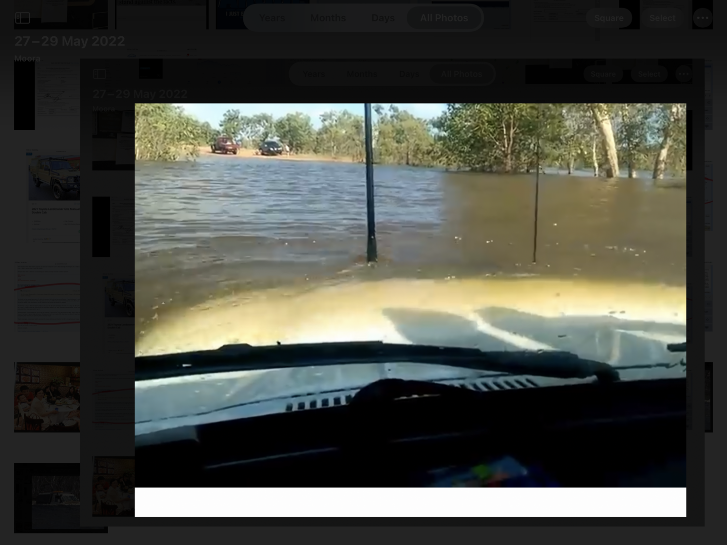

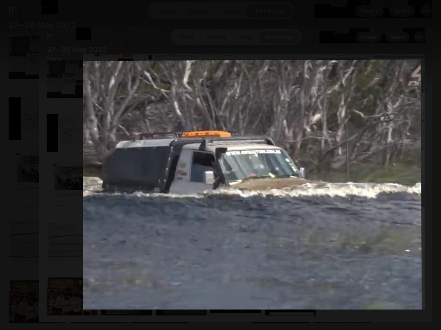

During my stay in Papa new Guinea, we did a bit of 4wd trekking about the place, this involved fording rivers using our Toyota land Cruisers and Nissan patrols. None fitted with snorkels, we had no trouble with the engines ingesting water, but heaps of trouble with ignition, probably caused by the fan picking up water and spraying it over the electrics.
