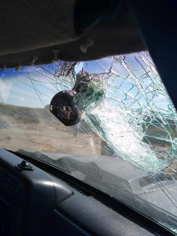

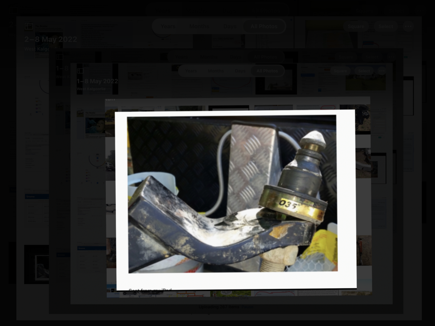

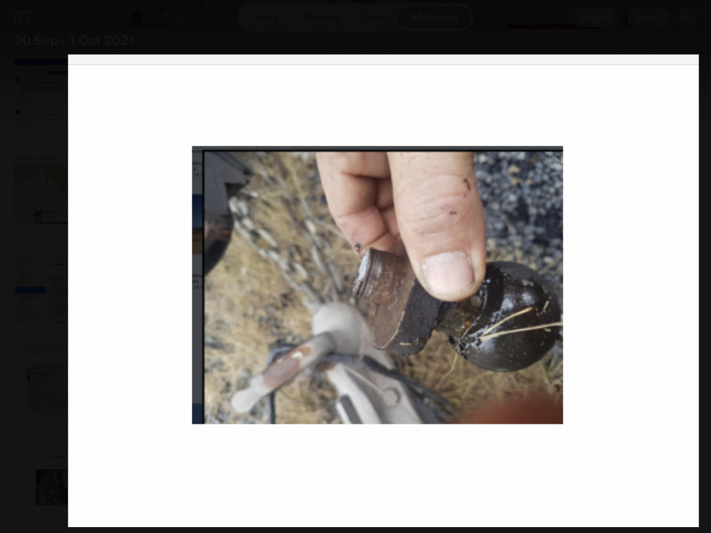

yobarr said
01:43 PM May 7, 2022
jegog wrote:
I don't think many tow balls are fixed at the correct tension. Just as tight as can be achieved with the biggest shifter or stillsons. The WDH I bought stipulates the torque for all the nuts including the tow ball.
That's right Dennis, and this can be the result. Cheers
Both pictures confirm that it is the shank of the towball that has failed.
Now, what could cause a large threaded shank to break like that, shear forces on a stretched piece of metal?

yobarr said
06:54 PM May 7, 2022
Peter_n_Margaret wrote:
The lateral (forward and back) load rating required for the tow bar is 2 x its tow rating. The towball requirement is probably similar, but they do break when used for recovery. Cheers, Peter
Simply leverage at work. Cheers

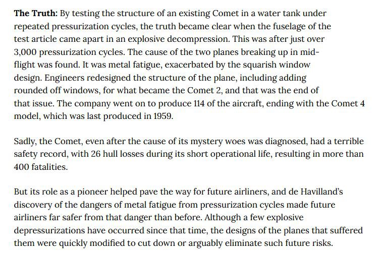

jegog said
01:11 PM May 8, 2022
Mike Harding wrote:
I suppose (is there a mechanical engineer in the house?) that a tow ball and caravan are, essentially, moving at the same speed and it is only when the caravan lags the car by the play in the hitch that a shock load occurs? This lag distance will be, say, 5mm so the difference in speed (inertia?) of the van/car will be minimal - it is not as though the car doing, say, 30kph suddenly has a caravan hooked on its towball.
Personally I don't like towballs as a hitch mechanism and I don't like snatch straps and given how easy it is to use the pin rather than the towball I'd always go that way - a towball is 500gm of solid shot heading your way fast!
I don't mind risk taking but why do it if you don't have to?
All the rivets in the Commet jet planes were moving at the same speed as the rest of the plane and yet they failed.
Pure and simple metal fatigue was the culprit. Same with tow ball shanks. Tighten the nut too much and all those small shocks from potholes and corrugations advance the metal fatigue
Classic metal fatigue photo.
yobarr said
03:47 PM May 8, 2022
Here we have what I believe is the best hitch of all, a DO35, and it is clear that this example has had some very strong forces applied. Didn't break though. Cheers

jegog said
10:21 PM May 8, 2022
Plain Truth wrote:
According to a University of Birmingham paper
"A further 1826 simulated cycles were completed before fatigue failure of the pressure cabin from a crack growing from a rivet hole at the forward port escape hatch"
