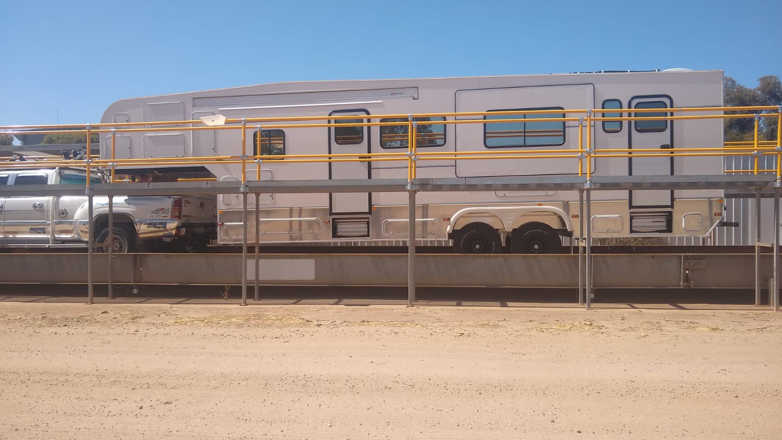

Our new home finished after a long time building it (with other activities in-between). Finally registered with compliance plate from Canberra and all the features I planned are actually present and working. It's a looong list :)
Just a few numbers, this is what people usually ask me.
The van is 11.03m long, 2.46m wide (official measurements). Height 3.4m
Tare 5.5t, ATM 7.0t, GTM 6.0 (that's the max axle load). Coupling weight 790kg.
The tare includes everything (solar, fridge, deck, mattress, recliners, TV, generator)

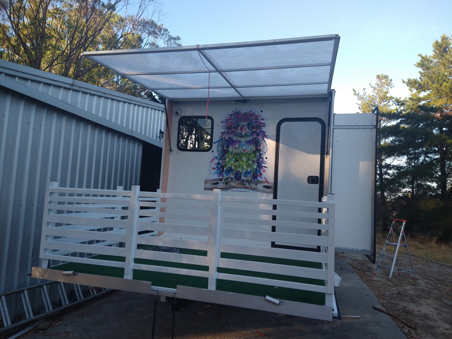

Here is a pic from the rear with the lowered deck.
regards
Gmd
