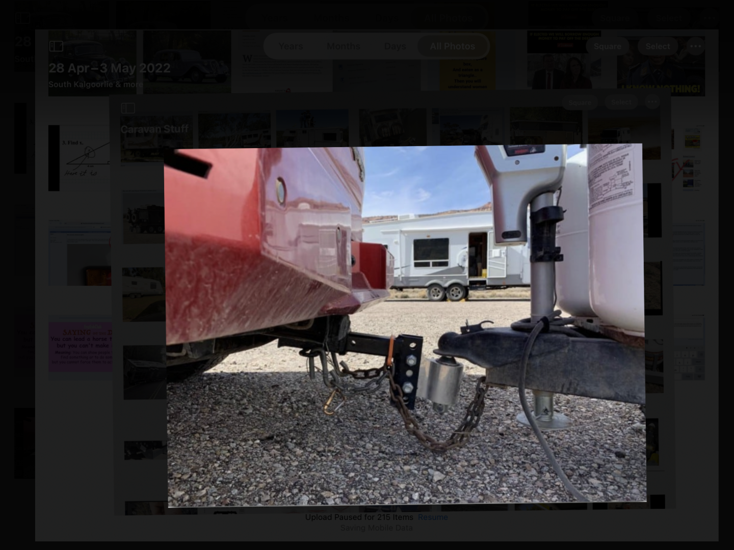

Even the chain around the ball shank looks good to me.
Long Weekend said
11:57 AM May 3, 2022
But the way the hitch itself is bent up doesn't look good!
Murray
Bicyclecamper said
12:04 PM May 3, 2022
Has to be overweighted plus, the hitch has only been put on a plate out the front of the A frame, that is not good enough.
Mike196 said
12:20 PM May 3, 2022
Won't be long and he'll be able to put his new one on!
bratboy said
12:24 PM May 3, 2022
Move a couple of cartons of xxxx to the back of the van SALL GOOD

Bugger, wouldn't you hate that in the middle of your big lap. Looks like a fairly smallish trailer by the size of the RHS. I had it happen to me many years ago, was towing a box trailer laden with camping stuff up to Lancelin north of Perth.
The trailer draw bar was only angle type steel not boxed, so the Draw bar collapsed while dragging the trailer through some sandy winding tracks. Fortunately when it did I was only a couple of hundred metres from the camp and with help was able to drag it the rest of the way.
There were Cray fisherman on site in the shacks there and they helped me straighten the drawbar a bit, then welded a couple of bits of angle over the top to give it some strength.
I did get it back to Albany after our camping trip and had a new draw bar fitted...but up until then had shown no signs of fatigue...

Where is the centre left chain going?
yobarr said
05:51 PM May 3, 2022
Good point Craig, but I suspect that its purpose is to prevent the drawbar from hitting the road if the trailer comes off the towball, as is REQUIRED BY LAW. After much consideration, I built a vaguely similar system on my car, so that if the van jumps off the DO35 hitch (unlikely?) the drawbar will be supported well clear of the ground. As someone has suggested, the drawbar design leaves a lot to be desired, with the head unit bolted to a very thin, unbraced, tongue. Good to see the ubiquitous tie-down being utilised though! Cheers
P.S Another pointless exercise, with this chap apparently unable to even afford any tie-downs. Cheers
-- Edited by yobarr on Tuesday 3rd of May 2022 06:15:02 PM
Interesting. Love the S hooks to connect the chains. There is a carabiner clip in there as well. And how about taking up the slack with a cable tie?
However, does anyone have an idea of what the device on top of the jockey stand is? And the gas bottles seem to be a lot larger than the normal ones on a van.
Maybe that jack stand is electric and it's an electric motor?
