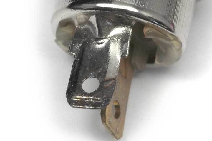

As said, don't use the standard 12v socket. Apart from the plug working their way out. The back of the socket connector for the spade connectors is thin & has poor electrical contact.

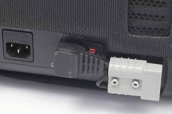

I replaced it with an Anderson plug which fitting in the existing hole & put another Anderson plug on the fridge with a 7amp panel circuit breaker from Jaycar.
