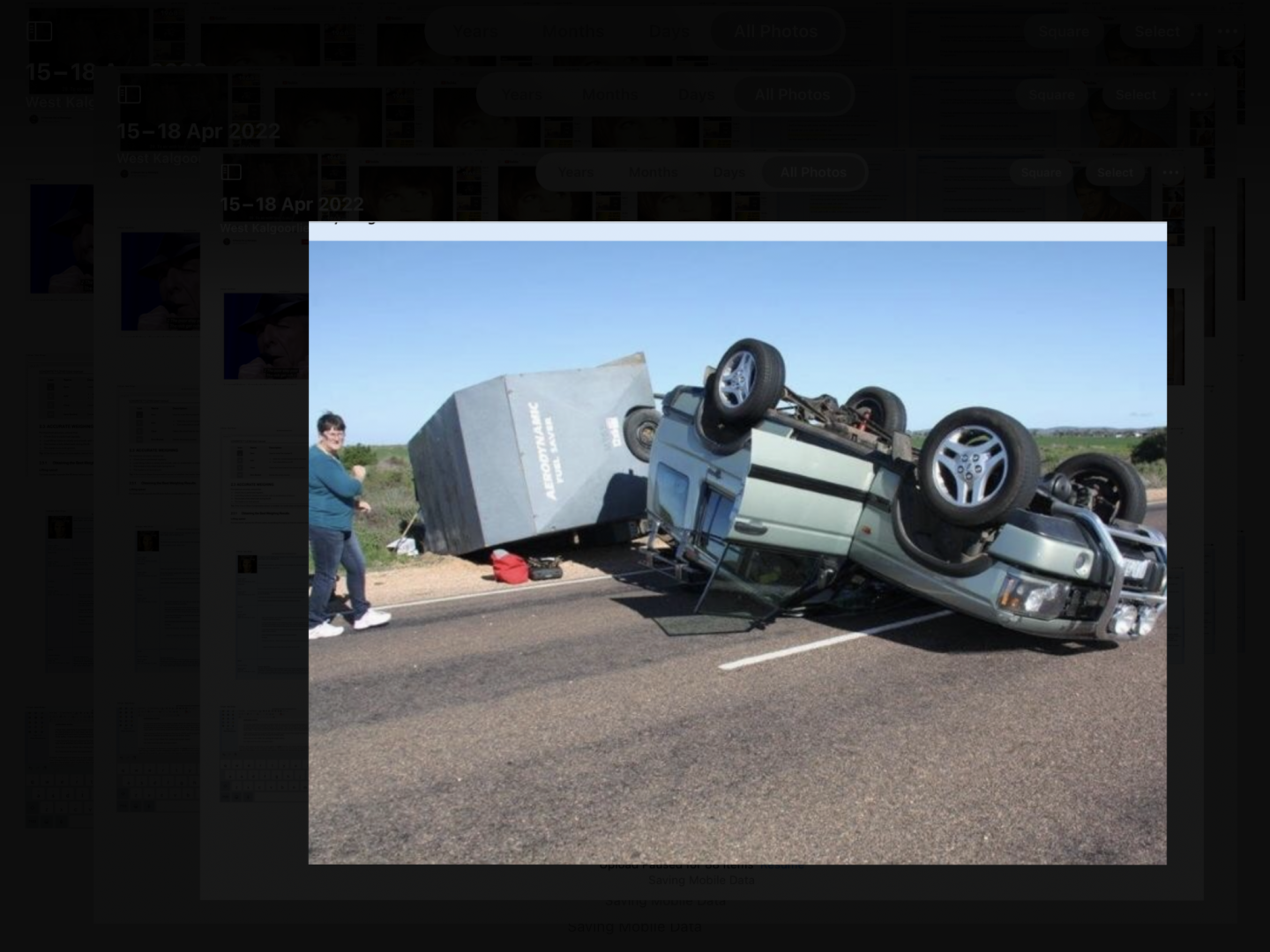

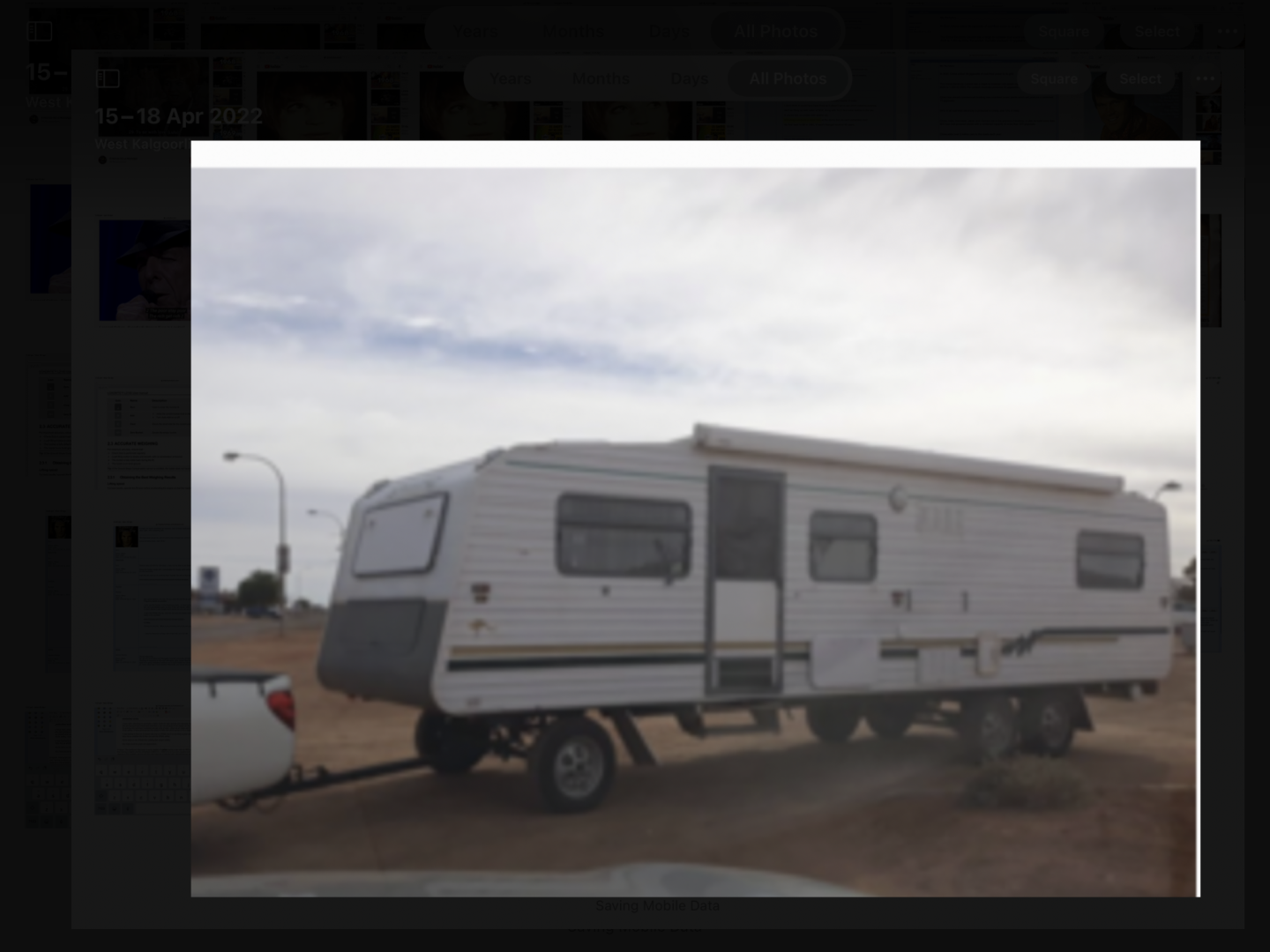

P.S The first photo is what is known as a DOG trailer, where there is a steerable front axle carrying much of the weight. This means that there is next to no towball weight (maybe 20kg?) on the car, and is the only way the more popular twin-cabs can tow a 3500kg van. Last photo looks like some sort of a Landrover, but accidents happen to all cars!
