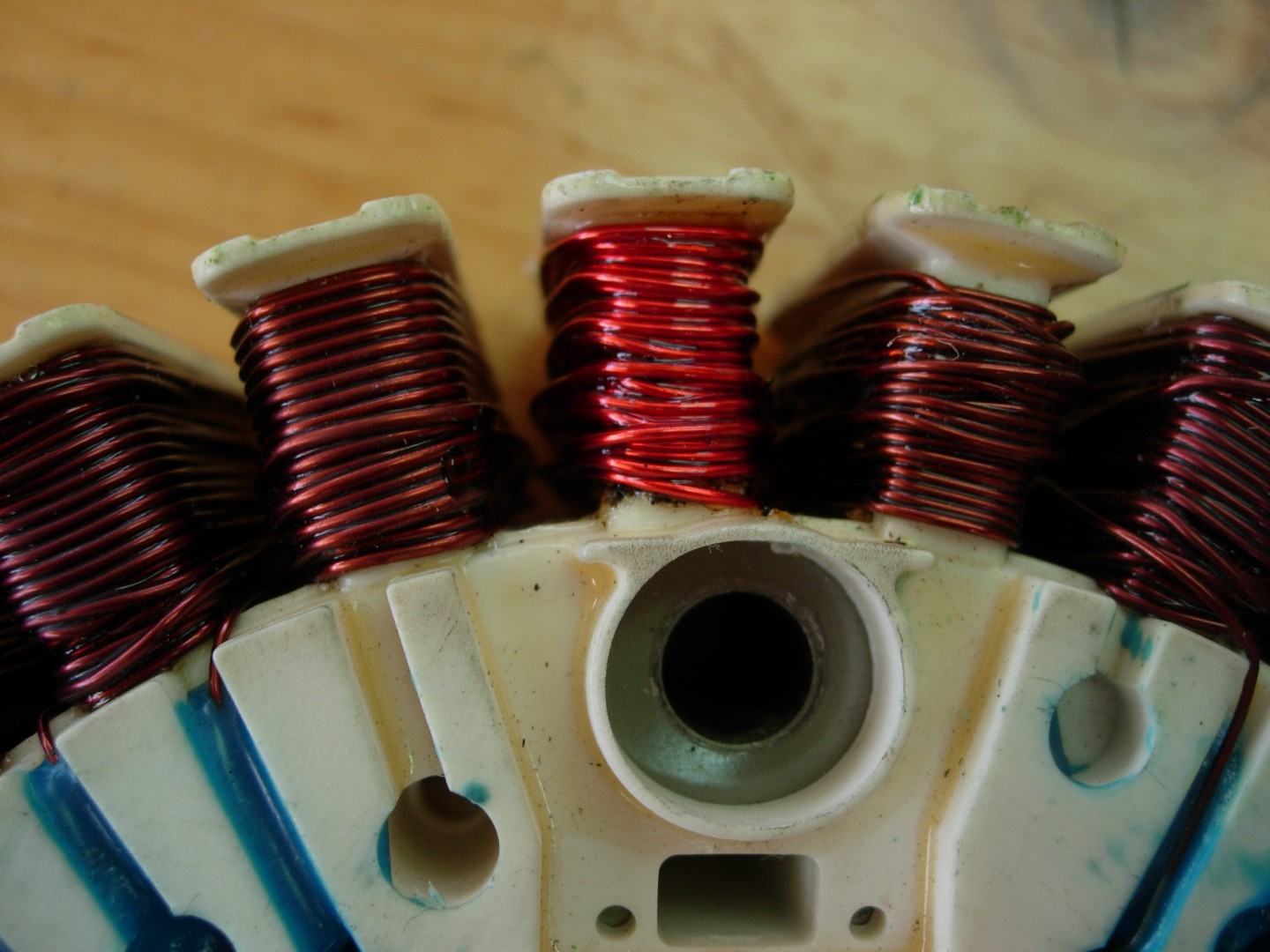

Hi can any one help I have an ef2400is & the stator is gone an Australian one is around $750 but I can get one from America for $129 US but no one can tell me if it is compatible with our model or if it will put out 230volts or only put out 110volts does anyone out there know
DeBe said
06:26 PM Mar 25, 2022
My personal experience with Inverter generators is if the Stator is burnt out , theres a fair chance the Inverter has a short circuit in it that burnt the windings. I have re wound the burnt windings on one & its easy to do.
Hi DeBe the stator doesn't look burnt out like your pictures it looks perfectly fine but I had it checked out and was told it was dead it has aluminium windings if that makes any difference

If it has Aluminum windings then its very cheap construction (surprising for an expensive generator) Even the cheap generators use copper windings.

Also the Stator voltage from America will be too low as it will be for 110V.
jegog said
11:05 AM Mar 29, 2022
US is not only 110V but 60Hz. Totally unsuitable.
But a good auto electrician should be able to repair it. They can repair alternators and starter motors.
