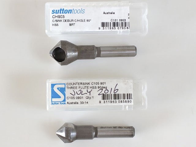

I misplaced my Sutton 3 flute countersink & bought a cheap one. It barely countersunk 2 holes as it was being cut by the material. Avoid the rubbish tools!
In the good old days ( PMG Tech in Training) I was a wizz at sharpening drills, I think over the years I have partly lost that skill ( and dipping into water to keep the hardness up). Bought a device that could sharpen them but the internal grind stone wore down and then was NBG.
Like Sutton Drills from the Green shed.

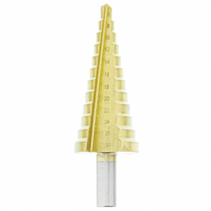

I bought a three piece set of these at Gasweld, brilliant so far
Mate, you could also use that as a Xmas tree in your van.
Craig1 said
01:41 PM Mar 7, 2022
Ah, thanks Chief, no messy pine cones or needles either. But might have to get a suspension upgrade, they are a heavy bit of gear.
02:01 PM Mar 7, 2022
It's a bit like architectural sugar *
An architectural tree!
* cubes
Cross hole countersinks are great.
