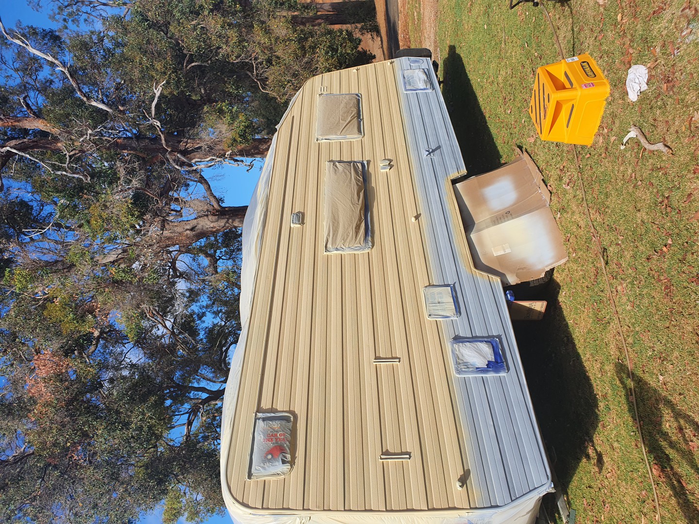

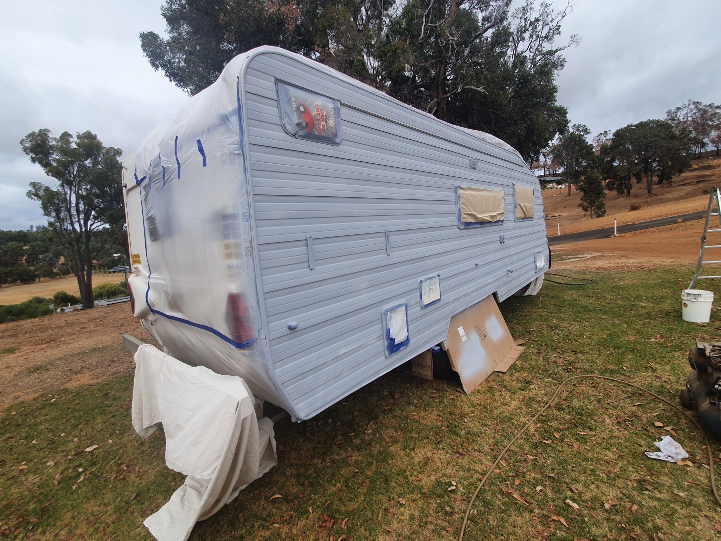

Yep, giving my van a birthday, after realising two AGM's were not cutting the mustard I wanted a few days of off grid so ripped out the old and 5k later, 4x 100ah lithium, 3000w inverter, Victron dcdc charger, MPPT solar and 15amp victron charger all through an outback marine distribution board with isolating switch and Victron BT smart shunt. Oh well may as well replace all the ceiling lights. Now to replace two 60l water tanks with 3x 75l. And then paint it. Lots of work but satisfying doing it myself.

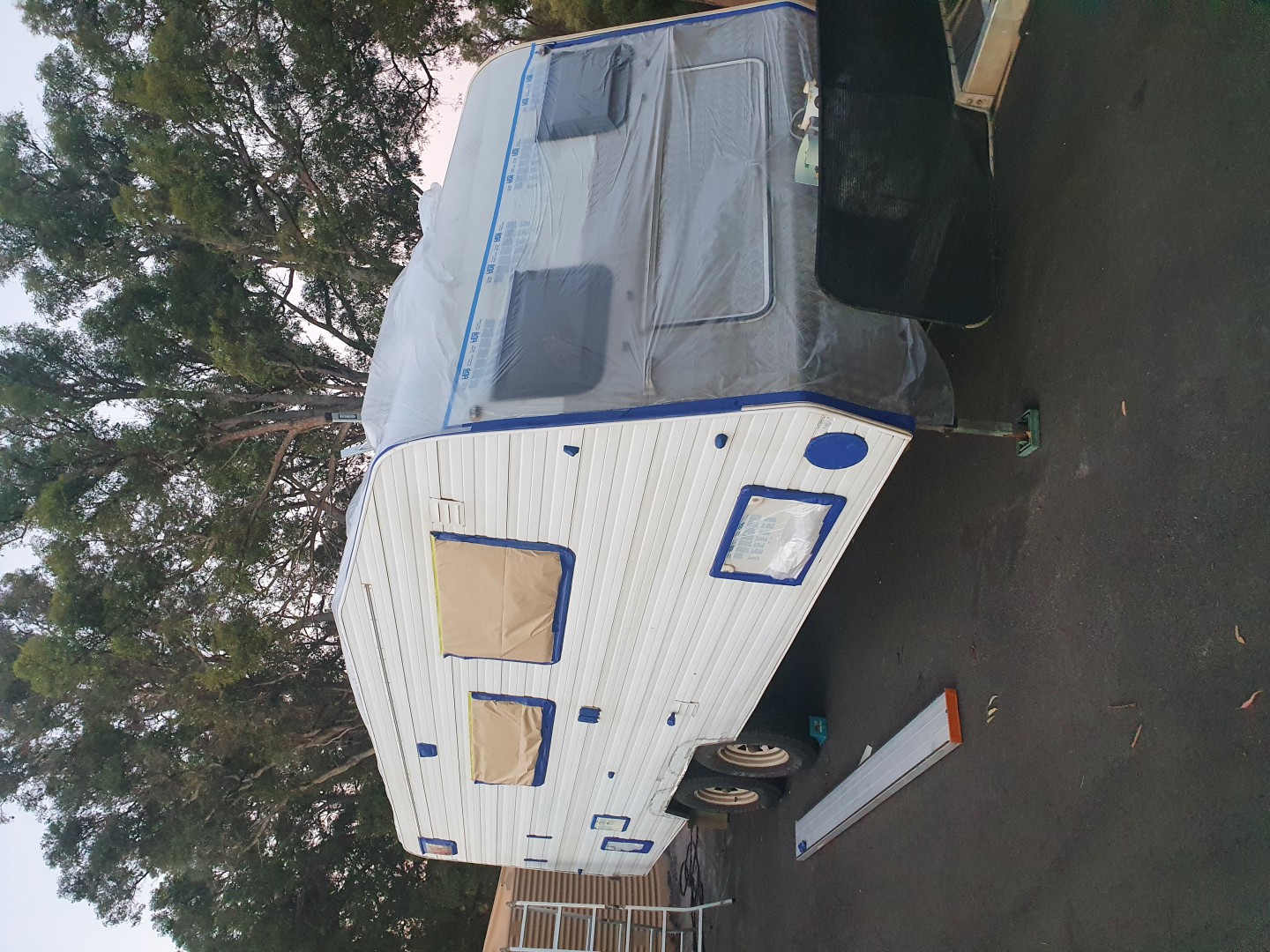

Nothing like comfy repaires or mods ! Just makes it so much nicer !
That looks like the stomping ground at the back there Stretch.......Bridgetown.
Think you should go back to the Coppers, to much time on your hands with all that masking up.
Well done ............cheers Bob

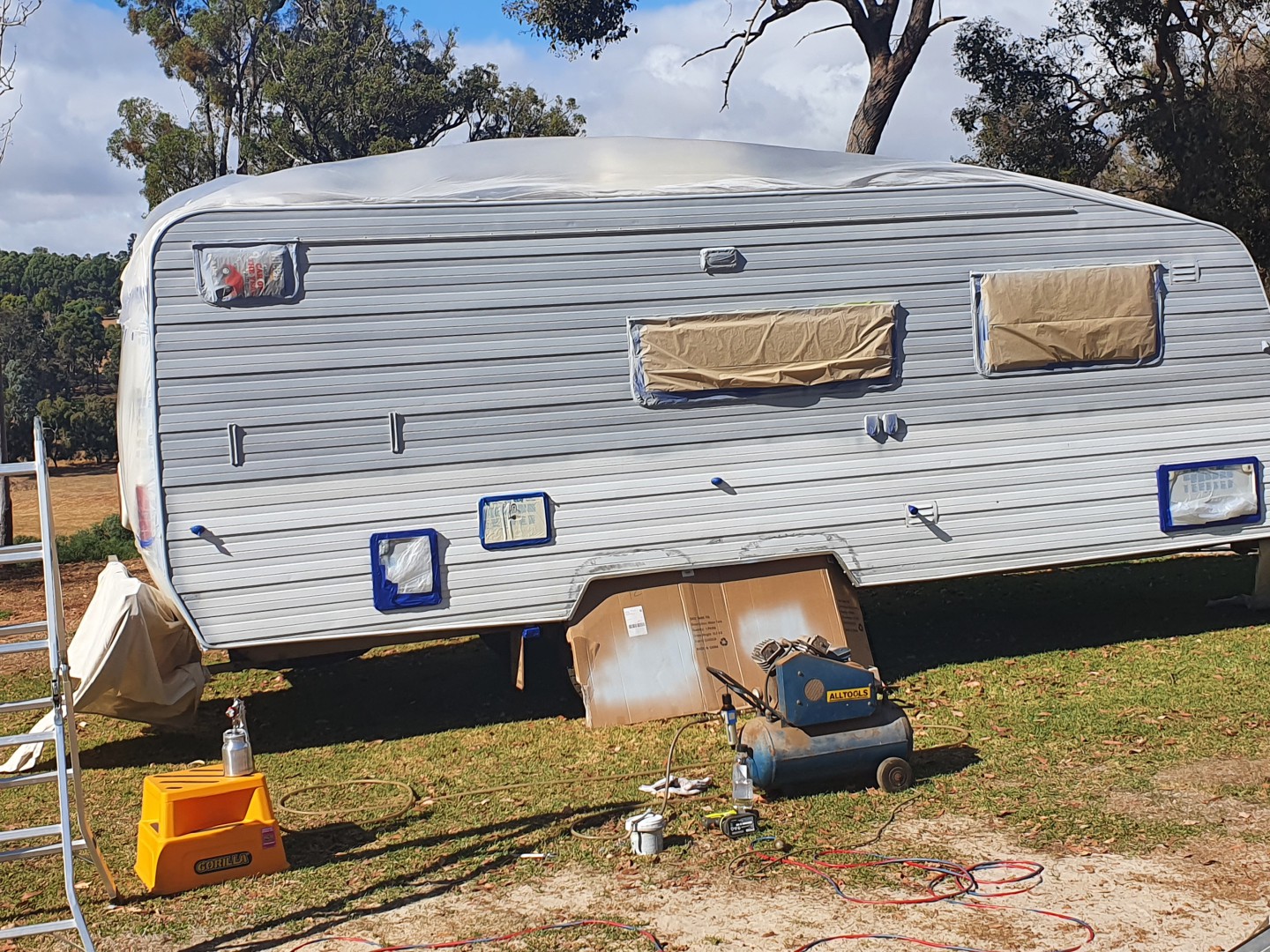

How rusty is the inside of the air tank?
The moisture trap should be must further down the line to be effective, & preferably after an aftercooler.
Better still, refrigerated aftercooler.

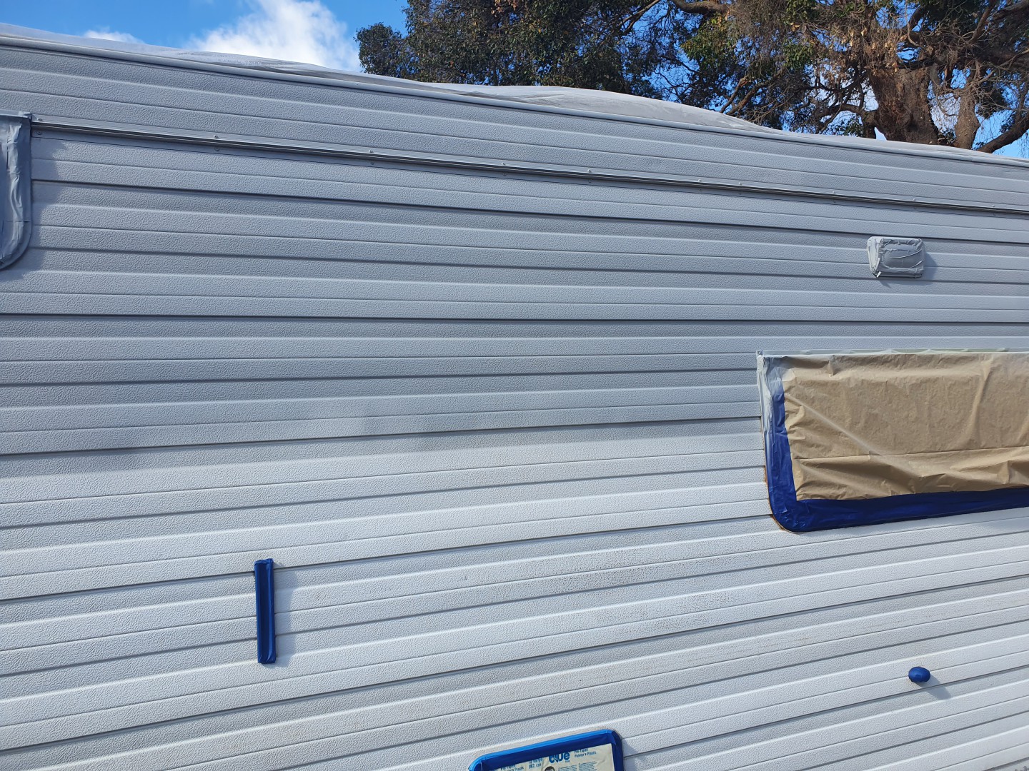

Don't know much about the air tank other than it is over 40 years old and old mate next door paid off his first house by fixing up old holdens and ford's spraying them and selling them. Not complaining about my first attempt at spraying. It is an industrial coating and bit heavier than automotive paint. Came up a treat after second coat. And Bob, wouldn't even consider going back. You left Bridgy about the same time I left Barker.

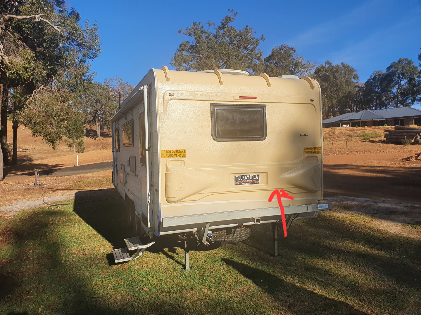

That's one heck of a slope that you're parked on there.
