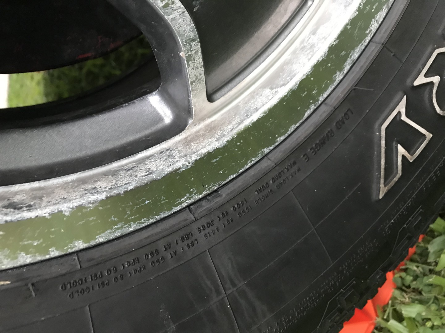

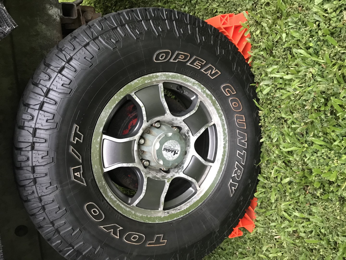

RobDor said
03:38 PM Feb 20, 2022
I use this calculator for tyre pressure - http://www.gnschassis.com.au/tyre-pressure-calculator/
Heres a couple of pics of tyres and calculates to 67 psi. Rides along very well.

Peter_n_Margaret said
07:31 PM Feb 20, 2022
Your pics clearly show that that tyre has a maximum load of 1550kg each at a maximum of 60psi.
At 67psi it is dangerously over pressure.
I assume it is a tandem axle van?
There are 4 tyres carring a total of 2,600kg. That is 650kg each.
When I enter your figures into the calculator that you provided it says that your tyre pressures should be 25psi.
How did you conclude 67psi?

Hi Peter.Whilst I don't remember the exact figures,when I visited Rob's home in Cairns to help him with getting an ATM upgrade,I also did all the figures for his tyre pressures etc,and it all seemed OK.He has a single axle off-road type van at 2600kg and his pressures were correct,according to the calculation that I use.Perhaps Rob could post his tyre details so you too can give an opinion,but unfortunately I don't recall details.Rob is being very responsible in safely and legally setting up his van,so will be receptive to your assistance.Cheers
08:18 PM Feb 20, 2022
There is no way that this tyre can safely run at 67psi. If it is a single axle van, that makes the appropriate highway pressure about 50psi.
UNLESS I am misreading that 60psi and it is really 80psi???? That is a seriously high pressure for a passenger tyre.
EDIT.... 560kpa translates to 80psi, so I need to appologise to the OP.
I would be interested to know the tyre size and load rating.
-- Edited by Peter_n_Margaret on Sunday 20th of February 2022 08:25:40 PM
Hi Peter.The tyres that Rob is using seem to have the same load specs etc as the tyres that I have on my car.They are 16 inch with 1550kg maximum load (Rating E) and 80 psi maximum pressure.Cheers
10:40 PM Feb 20, 2022
They are 265/75R16. Going to 285/75 or 305/75 would reduce pressures usefully.
watsea said
10:54 PM Feb 20, 2022
In an enlargement of the photo that shows the whole wheel rim of Rob's wheel, it is possible to read that the tyre is a light truck type.

Youre mistaken. its actually 80psi, not 60psi. Cheers
Yes correct. I recently had an ATM upgrade on the van and all that was thoroughly checked by certifier before getting blue compliance plate. Cheers

Theyre a light truck tyre designed for the job and running well within tolerance, so its not an issue.

Hylife said
09:47 PM Feb 23, 2022
That tyre can safely run at 80PSI !!
always use the single pressures, in your pic its 80PSI.
The double is for side by side like a truck rear axel, not a tandem van.
Same as my van's tyres, 80PSI at 1550kg, so mine run at 68PSI
-- Edited by Hylife on Wednesday 23rd of February 2022 09:49:16 PM
-- Edited by yobarr on Sunday 20th of February 2022 08:35:09 PM
I would feel decidedly uncomfortable asking a tyre on my van to carry 1350kg plus...adding the inevitable additional sway that a single axle van will have generating extra heat.
At the very least if I do pop a tyre there should still be one good one holding up the van on that side reducing the chance of a rim digging in and causing me additional drama and damage. Though I am sure the manufacturers have done serious calculations as to safety levels of tyre / rim / bearing requirements. Light Truck type tyres would be mandatory on any van.
I understand why some people opt for a single axle. Though it seems the single axle "Hybrid" type vans are getting much heavier with more and more luxuries being added. I have seen single axle vans with potential GTM's pushing 3000kg!
I agree that it is not overloaded. There are tyres to carry any load. My single axle off road trailer has the same tyres as the OKA, so the tyres are are good for over 6T.
On poor roads touugh it is preferable to operate at lower pressures, so larger diameter, larger section tyres have a distinct benefit.
