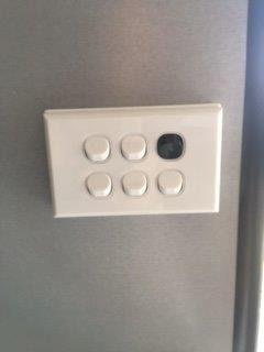

Bobdown said
04:38 PM Feb 11, 2022
My 12V isolating switch (black one) is just inside the entry door, nothing will work when that's off.
on my van [jayco] the switch is on one of the beds right next to the fuses. The battery is right next to it under the bed. I expect any switch would be near your battery/electrics but I don't really know.
did they not do a handover when you got your van to show you everything? My van is secondhand, I paid for a 'handover' to find out about things.
The reason for the problem I had is what people are saying. The charger in the van can't work if the voltage goes too low.

yes the handover was 1 month after build so was 16 month ago only used the van 2 times in that time [ thanks covid] I may have forgotten? but kept the van charged, not sure why it went so low but it did so I do suspect as you say it went too low for the charger to recharge
as for this switch as above with bobdown pic there is no "black" switch anywhere in the van nor any switch I do not know what it does.
