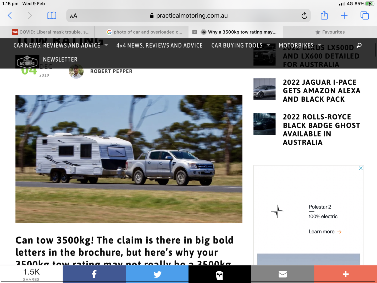

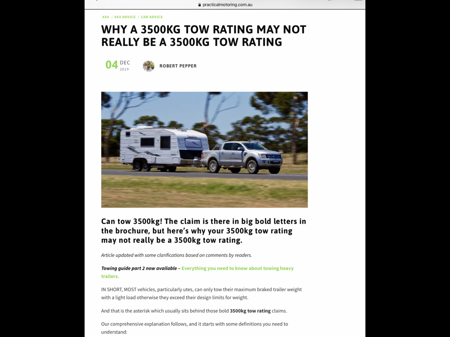

Practical Motoring.com.au posted this article a couple of years ago.Might help some to understand if they care to look at it?
