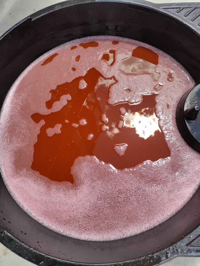

tuggersbmx said
08:51 AM Feb 9, 2022
How does this coolant look to you?
This was the coolant in the bus when it overheated and then I topped up. When I repaired the radiator hose I had to drop the coolant into a tub and then use that same coolant refilled through thermostat and then topped up with some water.
Could the colour just be from dropping / reusing it?

landy said
10:20 PM Feb 9, 2022
Some coolants are red do you know what color coolant it was filled with after the rebuild.

tuggersbmx said
10:52 AM Feb 10, 2022
I did a radiator flush after engine install 3 times and put red coolant in. I did at one time have an issue with a thermostat but swapped it for a OEM one which solved that problem. All new hoses on radiator too when engine was installed.
