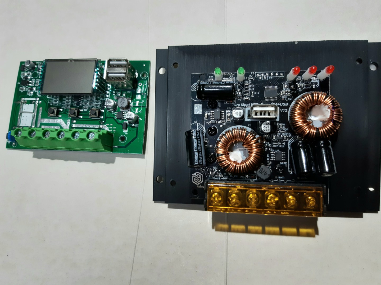

In photo the $18 PWM on left still works OK then tried the $40 Mppt on right which pumped in more amps, quick to get LEDs to display fully charged however it continued to charge@ 17.05V and 1.2A.
When retailer was informed they promptly issued a refund.
My experience ! I have used two EPever/Tracer units, one currently, One Victron currently. Both brands worked well and still do and priced reasonably when I bought them, the Victron is a better unit probably but seem to be well over priced these days. I do not worry about the bells and whistles models, eg the bluetooth as that does not make them work better, but your choice and might make them easier to setup. I did buy an MT5 remote readout(previous model) for the Tracer(I find it hard to see) but use some other meters also.
I note Renology get a good rap but I know nothing of them. I would not buy anything called Kickass, sorry just old fashioned, or indeed any other stupid branded stuff badged to attract the punters. Who knows they might be world class I will never know.

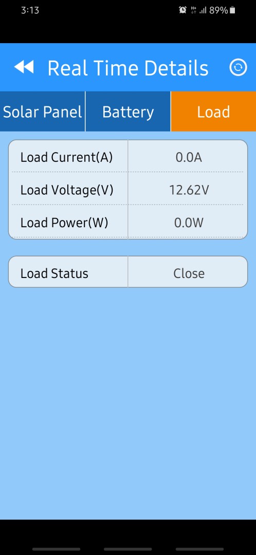

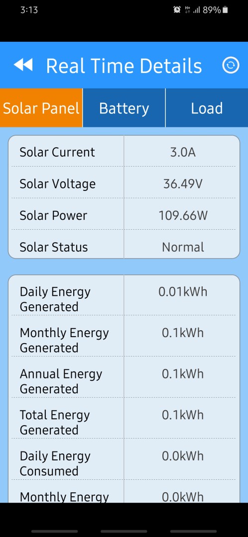

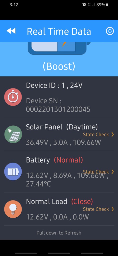

However, the ip68 30A 7810BP Epever MPPT works very well so far.
That unit from fitn solar, an ip68 comms 1.5m lead with another non ip68 ext lead and a blue tooth unit (non IP68) for phone connection was $112 delivered.

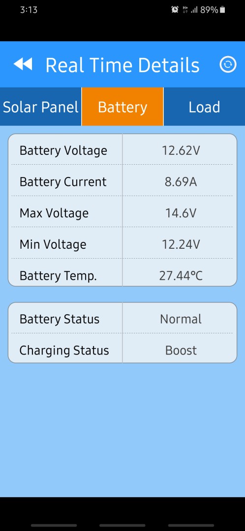

I've included phone screen pics of testing when the sun peeped out one arvo recently.
After looking at the solar irradiance website for around my post code at the same time I figured the output to be in line I think. (50-70%)

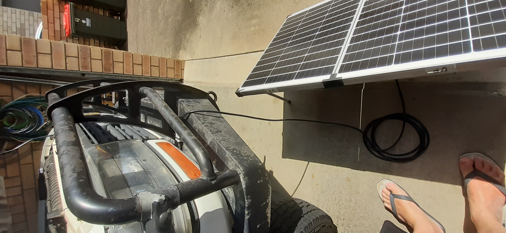

The results reflect my rewire of the Folding panels - in series. (Each Panel has a diode and I didn't add anything else ).

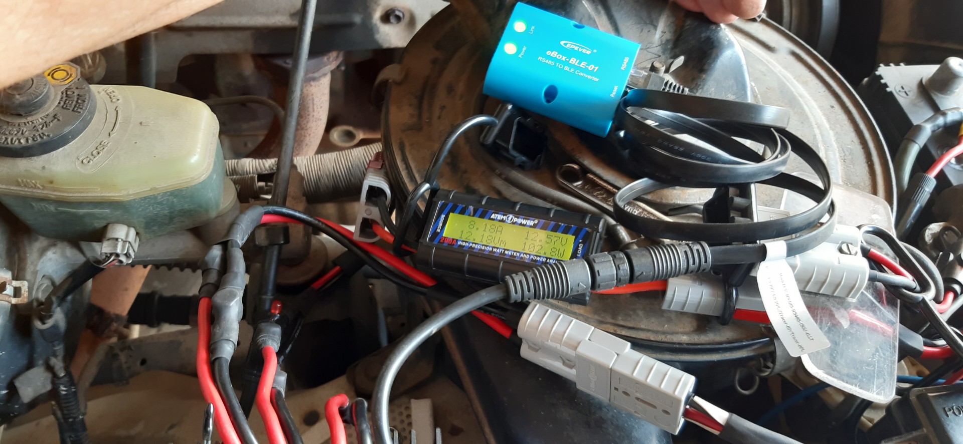

Made a studded mounting plate in engine bay for temporary usage as I'm not sure if permanent mounting in that environment would be detrimental even though it's ip68 ??
I could leave it there (upside in attached pic) and wire blue tooth unit to the dry dash area.... one day I might add a fixed panel but the car won't get under the roller door.
Added an internal extension lead to Bullbar for panel connection. @plain truth.

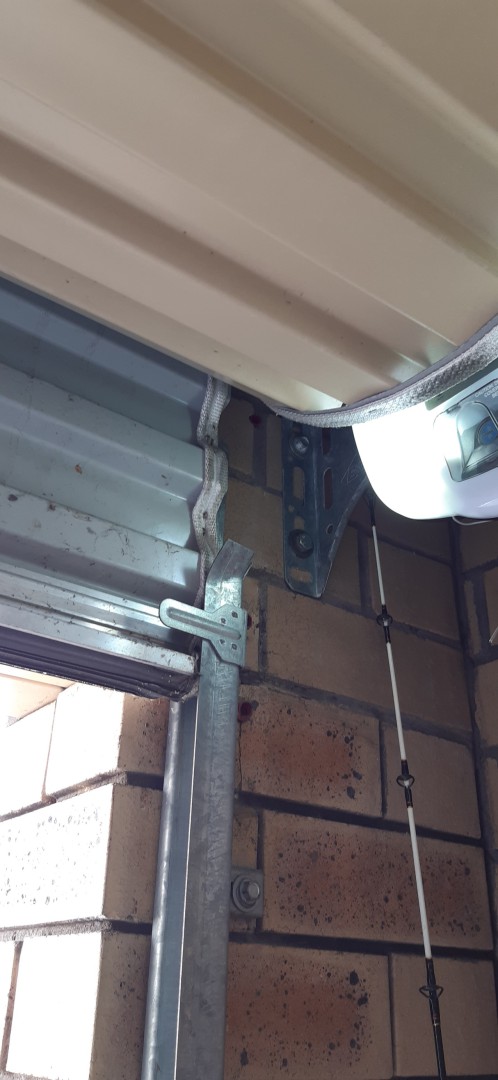

I couldn't get under my roller door. Straightened the curve in the cross bars, all 4, a job in itself, which gave me a few more cm. If I don't sit in the car the roof rack touches the roller door. If I sit in the car as I have to to drive in & out of the garage there is a few mm clearance. Have to keep drinking beer!
Look at the bracket on the roller door. Even though it is welded on you can add a spacer, you may be able to gain about another 30 to 50mm.
In the meantime we got a new garage door & I asked them to put this bracket up higher, explaining that I need more clearance, they saw my car. It was not an issue. So it can't be that critical. Two years on there has been no issues with the extra clearance.
P.S. spray a bit of Selleys silicone zip spray (or likewise) on the roller door guides a few times a year.

Took a pic showing vertical guide rail length limitation, I guess they could be lengthened and the whole roll mounted higher.
About 10 years ago I bought a cheap "Super Cheap Store" 15 amp controller that was an MPPT, and put it in my caravan. It worked as intended, but at that time they were into caravanning and camping so maybe they do/do not carry them now.
05:07 PM Mar 11, 2022
It looks like the bracket on your track is almost as high as mine, but my bracket is higher than the other garage doors as I requested. The roller door is also squeezed up as high as possible as we have a very low roof. The black stuff on the door is 3 & 6mm acoustic insulation which is also good for thermal insulation.
I'm on our committee, for decades, sometimes pays not to say things that can't be seen.
Sorry for getting off topic.

Hi Jonathan,
I measured and found I can only gain ~35mm due to the brickwork and lintels.
I could bend the tracks"stoppers out of the way and screw on another close to the top of the track ( the angled lead in end part of it) to get that.
So perhaps so, if I can Butcher (shorten) my roof rack clamp top ends and fit crossrails to panel ends.
Maybe a total height above vehicle roof of ~ 50mm then
Food for thought thanks. A future project.

I did worry about leaving the array beside the vehicle on roadside when unattended for hours.
Both pcb's have 6 transistors underneath.
