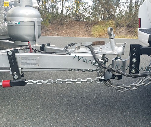

Based on previous discussions and what happened I resisted responding to this, but the magnet was too strong.
I have an Andersen Hitch and have no problems with it (note the correct spelling). The Hayman Reese is more widely known but I have never used one or anything else to compare. I suspect that the Andersen would be stiffer because all the compression is in that little red urethane "spring".
Addressing Rob's comments: Cone bush flogs out easily. Back in 2019 I found mine was creeping upwards and developing some cracks, so called the distributor. Turns out there was a design change a couple of years ago. They they sent me a new triangle plate and bush, along with a bottle of some lubricant. In over 20,000km towing since then it is still fine. Never makes any noise to speak of. I note the website now shows a different bush in the current models.
Arms become loose on the drawbar. Not for me. Maybe an installation problem? There are set screws to hold the brackets in place and the installation instructions said to optionally drill small holes where they go, which is what I did. I also put the brackets at a slight "prestressed" angle as per the photo above.
How much weight does it transfer? As much or little as you like. I set mine to move about half of the lost weight back to the front wheels.
So, why did I choose Andersen Hitch over Hayman Reese? Mainly because with HR I don't like the bars that hang down low under the drawbar. Maybe HR could be easier to connect/disconnect, but there would not be much in it. My technique is to connect up, and then wind the jockey wheel to raise the drawbar and car rear end up. Insert the chains in the brackets and tighten the nuts. While the drawbar is raised this can easily be done with fingers. Then lower the jockey wheel and remove it. Done. Reverse the procedure to disconnect.
Having measured and tested everything before, I just visually leave about 5 threads showing. If I am going somewhere with a few deep bumps I will loosen it (socket spanner provided with the kit). I have never removed it when crossing service station driveways, etc, but can feel the stiffness showing it is working hard. I actually tested it crossing a creek, but chickened out when I thought the rear wheels were close to lifting off the gravel. The stresses must have been huge.
The design supposedly inhibits trailer sway by having high friction that resists turning. The more it is loaded, the greater the friction. I can't see it doing a lot, but have no doubt it helps.
Edit: I see Olbloke responded while I was typing this. I very rarely de-tension the chains yet have had no issue with the brackets moving. On that basis I don't see it as a design issue. But if it's a concern, put a couple of bolts through the drawbar.
-- Edited by Are We Lost on Saturday 29th of January 2022 08:29:47 PM

Are We Lost said
01:43 PM Jan 30, 2022
Yes, prety much as you say.
I don't actually count the number of turns, but use the length of exposed thread to decide the tension I want. Like the chain tensioning of the HR type, it's a factor determined when installing it. I'm not too troubled about being precise, and in the rare cases I want to reduce the tension a bit I will just leave a little less thread showing.
One interesting point with the photo above is that the triangular plate attached to the vehicle has not been aligned very well and is facing one side more than the other. Looks like a haphazard setup for the photo. However, that is pretty much an aesthetic issue as the plate adjusts itself to equalise the chain tension each side once under way. The stiffness rotating that plate is what helps with anti sway. You can't budge it by hand (or hammer), but don't notice it when driving. I doubt it would do much with reducing sway, but it must help a bit.
Rob Driver said
08:31 PM Jan 30, 2022
I am thinking aloud again and when I look at the HR unit I see two bars that are functioning as springs or torsion bars.
When I look at the Andersen unit I see two chains linking the van and the car and these are tensioned against two rubber or similar type bushes which appear to provide a sprung tension to the chains when the nuts are tightened up.
I can see how the unit could act as a basic anti sway by the friction provided by the bush under the tow ball which tensions any radial movement of the plate and restricting the movement of the chains which in turn restrict some movement from the van chassis / drawbar.
For the unit to provide weight distribution it appears that the tension of those chains would be such that the connection and tension at the tow ball would need to be enough to cause the tow ball and coupling to lift to transfer weight from that coupling to the axles of the van and lift the rear axle of the car enough to transfer the required weight to the axle groups.
I am not an engineer but it appears to me that because the connection point of the chains are virtually under the coupling then I would be thinking that quite a tension would be needed to provide the lift needed to distribute the weight as required.
What are others thoughts?

Are We Lost said
08:36 PM Apr 23, 2022
Oldbloke does not have one, unless he bought one after posing that question. But the photo he posted is a good start. It may be clearer if I describe the way I fit mine.
With the van coupling secured on the towball, I wind the jockey wheel back down again so the drawbar is facing up a little, and so is the rear end of the tow vehicle. The car and van form a slight inverted V, with the towball being the centre of that V. It's only a few inches. But weight has been lifted from the car rear wheels and distributed mainly to the front wheels, and a little to the van wheels.
Then fit the chain. It provides tension between the vehicle and drawbar, below the towball level. It limits the ability of that inverted V to flatten. Without that chain, as the jockey wheel gets raised, the inverted V would flatten and then become a normal V as the car rear end sags. But with the WDH, the chain prevents the inverted V from flattening. The result is less weight on the car rear wheels.
Then, on the road, the chain keeps the rig taught like a board, this radically reducing porpoising. But the main benefit is with the dynamic nature of highway travel. When braking or going over undulations, any tendency for the car rear end to sag are resisted by the stiff nature of the design, which gets stiffer the more it is needed. The red bush you see in the photo is the spring that allows just enough movement.
I rarely find the need to remove mine, or reduce tension, but I would if going through a creek crossing or other deepish culvert.
The design also provides some level of sway control. This is achieved by having the towball assembly sit in a replaceable friction material. It provides just enough friction to provide some resistance to turning, while being undetectable when driving. How much it helps I don't know, but it's stiff enough to be impossible to rotate by hand when the van is decoupled, even with a solid hammer.

Here are my weighbridge figures. As the comments show it was intentionally loaded to the max, and actually a little over. With 160+L of water in the van and 40 in the tub it was not a real hardship. The figures don't quite line up due to the 20kg increments of the weighbridge.
Link to WDH discussion
Cheers for those weights AWL
It appears that they do transfer weight as required.
I dont seem to see that many hitches around, maybe the option should be considered by more caravanners. They are certainly easy to hitch and unhitch.

Lets move on. Well regarding the Andersen Hitch,, I think the way it operates by simply squeezing the ball and van frame from below is simply not as direct, or efficient as
the lever system employed by classic weight distribution systems. It has some advantages but inclined to think the traditional type is better. But I may be corrected.
And in retrospect I was silly to say the bracket on the van chassis was a design fault. Clearly it works.

I am looking at it and can't get the physics how it works and what forces it applies onto the trailer frame or the tow vehicle, so I have asked an expert.
How does this thing work because I can't find it on the net, an explanation of does it transfer weight.
I know how a the conventional WDH works, but this has go me stumped. I'll let you know should I get a answer.
