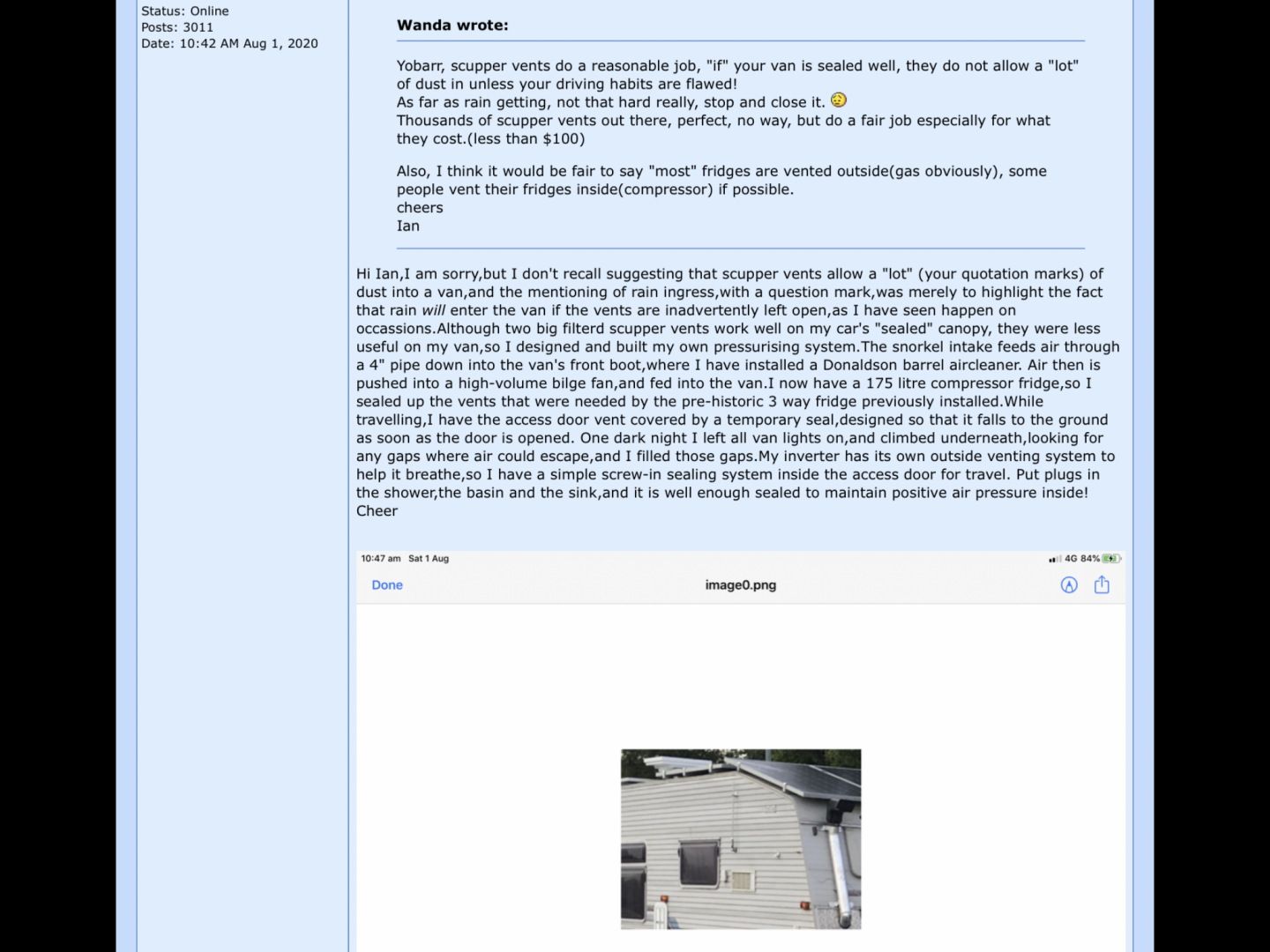

No time to post ,but this is what I did.NO dust gets into the van,and I've done thousands of kilometres on dirt roads and bulldust.Cheers
