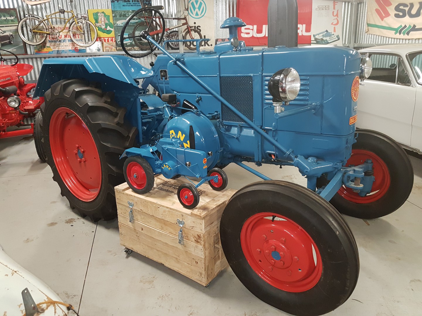

Here is a Pic. of a 1952 Lanz Bulldog D2206 (first of the Electric Start versions..) I have recently restored (and Scratch built the model as well) ..... KB

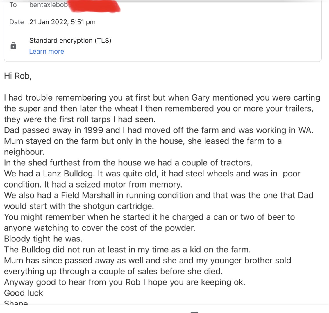

Hi to KJB and other members,
I want to say I was mistaken about the Bulldog and the shotgun cartridge. My memory has let me down from 30 years ago.
I contacted a fellow who new of one of the farmers sons. We exchanged emails and this explains my stuff up.
My apologies to the forum

Lanz Bulldogs are Started with a Blow lamp or after about 1952 electric Starter motor......... Field Marshall (English) tractors used a Cartridge to start.
Our memories are not always perfect Rob but it was good that the Topic initiated a "catch up" with an aquaintance of yours from the Past..... Cheers KB
