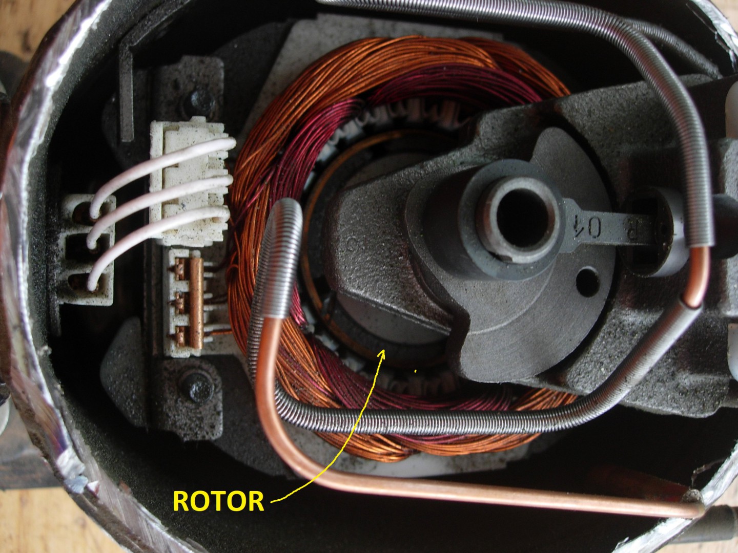

I have seen reference in a few places to the rotor, what is it? Will give the compressor a love tap tomorrow. Thanks, will advise if it liked it or not!
Thanks for the pic. I can see that its a cut open view! Nothings easy. I gave the compressor a bit of a thump. I stopped the fan so I could get a feel for what the compressor is doing, and it is vibrating away, as if the internals were spinning but its just not getting cold. Regas?? Now it also will not turn on on 240v. I left it running overnight on 12v supply, and decided to test it today back on 240 after the love tap but now it doesnt turn on. Put it back on 12v and it is back its normally non cooling self. Not worried too much about the 240v side, just odd that it stopped working all of a sudden.

I cut it open to find out why the compressor wouldnt run. It was a poor connection where the 3phase star windings are joined together with a bridging link. If your fridge needs re gassing then its probably not worth repairing.
