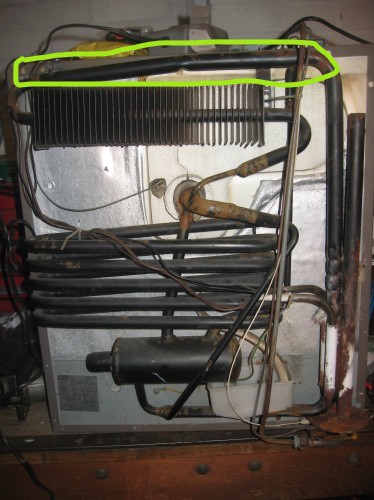

Take the top outside fridge vent off and feel the pipe indicated in the picture. It should feel "hot" enough to feel very uncomfortable about say 80-90 deg C.
(Your fridge may not quite look like this picture but it will have all the same components) If this pipe is hot at the highest point and cooler or cold at the lower end the Ammonia vapor/medium is stalled in the pipework.
With the fridge running for an hour or two, Try raising the front (Draw Bar) as high as possible and leave it for a period of say 5 -m 10 minutes. Then lower it as far as possible for a period. Then bring it back level.
I have never done this on big caravans only smaller Avans, but it has often got the cooling medium circulating through the system on friends vans.
have years ago even done the old "Remove" the fridge and rotate it 8 hours on the side+ 8 hours upside down+ 8 hours on the other side+ Stand it up and run it. That sort of worked but I still needed a new fridge.
