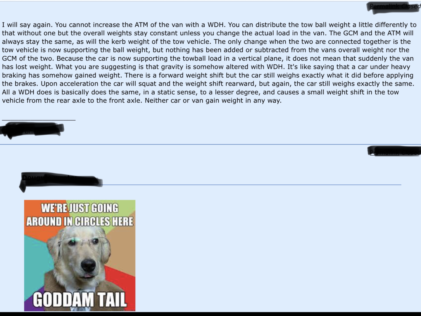

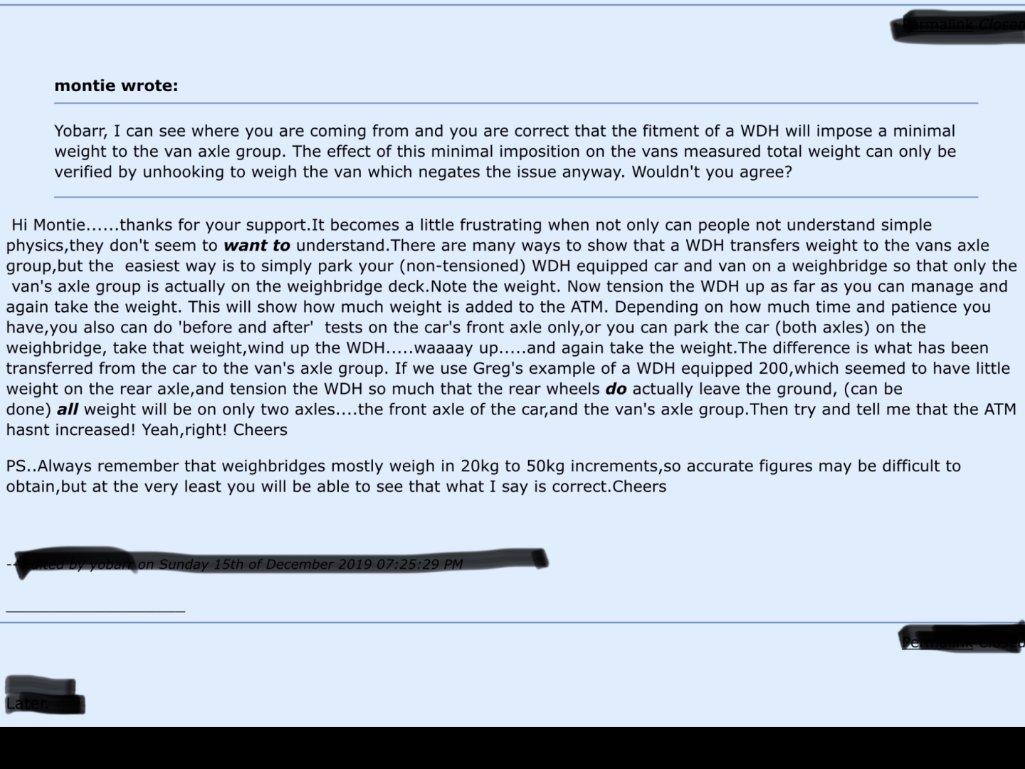

yobarr said
06:53 PM Dec 14, 2021
Here are screen shots of a couple of posts from the "early days",where my claims have been ridiculed by a senior member of the forum,and several others.There are many others if you would like to see them? This was before they realised that what I wrote was correct.All is good now though.Cheers
P.S I'm off to the pub now,so may not reply to further posts today.

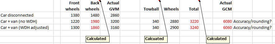

Well if the fulcrum is the center of the rear axle, or the point where the rear wheel is on the ground, I am still at a loss to see how "are-we-lost" ball weight has increased so much. Quote: However, when I put my 320kg drawbar load on the tow ball, the rear axle weight increased by 480kg and the front wheels lessened by 160kg. That was measured at a weighbridge, with 2 passengers, extra fuel and water, and loaded to the full 6000kg GCM.
I had a fresh look at the figures. The weighbridge had 20kg increments and it was at a dump site, so a couple of readings differred by about 20kg when calculating totals. The actual measurements were:
So the towball load of 340kg resulted in 500kg increase on the rear axle and a reduction of 160kg on the front. Once the WDH was adjusted, it transferred 120kg off the back wheels, distributing 80kg to the front wheels and 20kg to the van (yes, the raw figures show a discrepancy of 20kg).
The figures in red are where the loads were over the limit. It was packed to the gills with full van tanks, extra water, spare battery, fuel, beer and provisions, and would very rarely be driven like this. The weighing highlighted that I needed to get rid of a few things.
