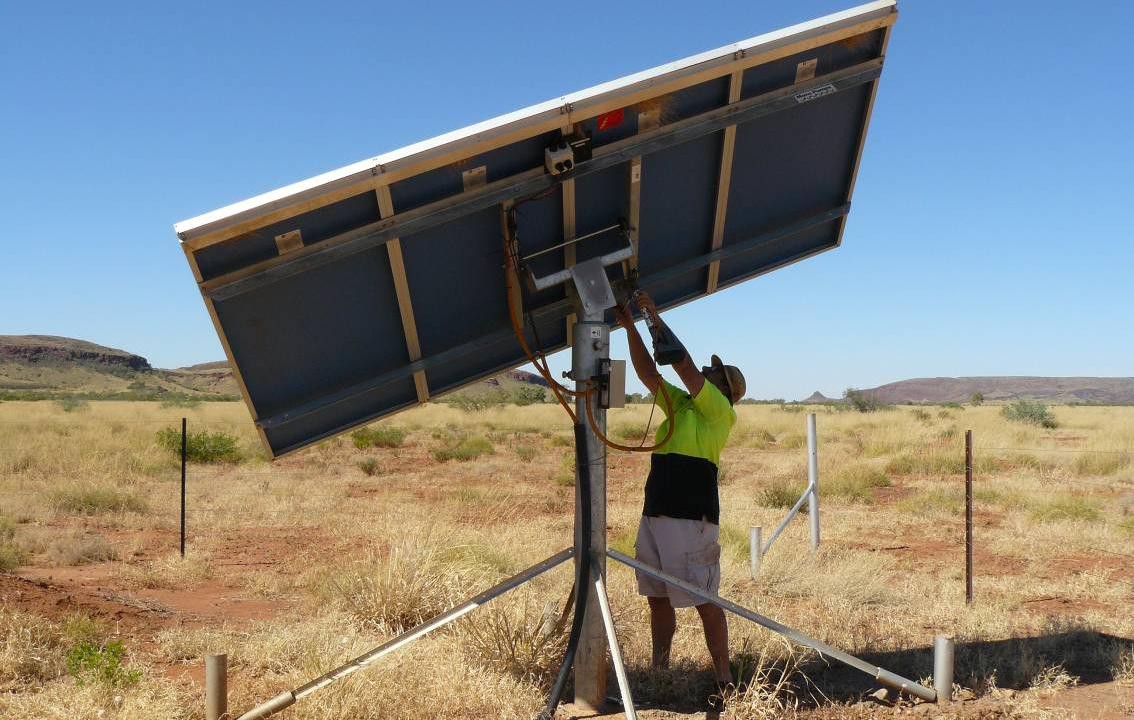

This tracker on a Pilbara cattle station was broken. I fixed the panel position to face north at the best angle.

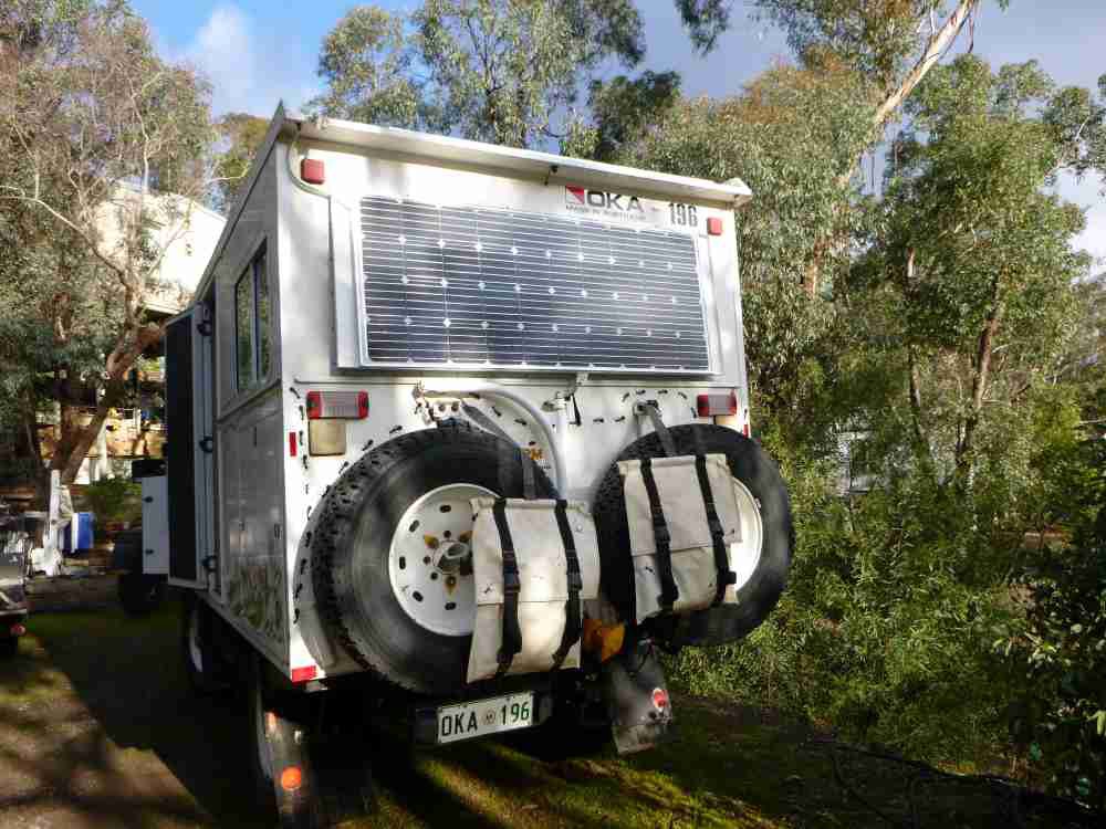

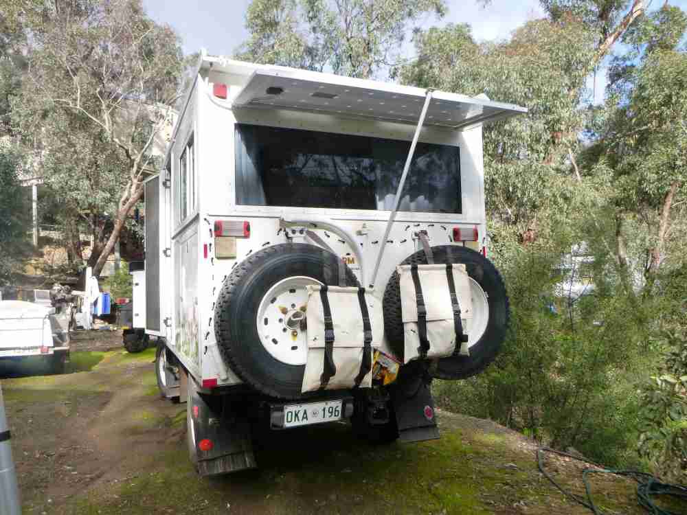

The first panels I fitted to the OKA had hinges that allowed adjustment. It was too hard and it was easier to simply add another panel.
The effective collection of a panel at the wrong angle is equivalent to the effective area presented to the sun.
