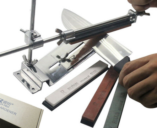

slowboat said
11:22 PM Apr 23, 2022
I use the Ruixin unit, it allows me to maintain blade angle, not something I can do freehand.
The piece de resistance is using the 8" bench grinder mounted cotton buff to remove the burr.
also an easy way restore an edge. 8" bench grinder is a bit awkward to carry in a van, so a good steel is next best option IMO.
I don't have any expensive knives, all just 'elcheapo's' from the supermarket and to keep them sharp, or good enough for "slicing & dicing', I have a $19.95 Kleva Sharp (red) that has a suction cup to stick to the bench, takes about 10 seconds to put a rough razer sharp edge on any cheap knife.
Just put a cutting board between you and the sharpener so you don't cut your bench.
