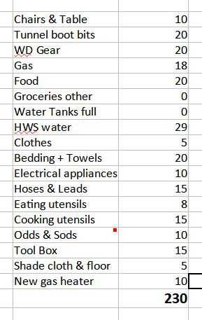

Montie, it purchased direct. All "extras" included. Solar, battery, awning, mattress etc were all included. They were not extras. When I picked up the van there was no water or gas. The variation is huge. Can't be explained.
If you look at my attached list of contents. The water tanks were empty and bottles filled with gas.

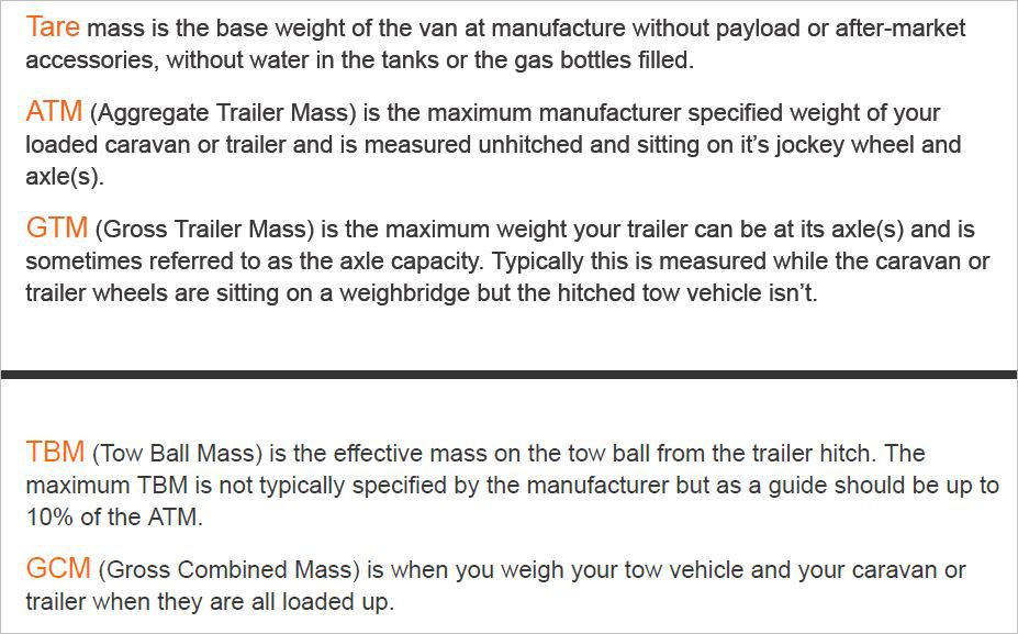

Never believe the plated tare weight! As a few have said, it is often an average, or "ballpark" figure from the maker.
Weighing the van "about 50% loaded" is fraught with peril. Take everything out, then get your own tare weight done. That will be correct (from a registered weighbridge). If there is a major discrepancy, contact the maker.
The van maker will often list the TBM as 10% of the GTM. The car and/or towbar makers limit is the one you need to be aware of.
When selecting the weighbridge you are going to use, enquire first as to the increments it weighs at. Then you can decide how accurate your effort to get the TBM will be, otherwise, for under $100, many autoparts stores will sell you a towball scale.
Remember your front and rear axle weights on the tow car should be checked as well. This is one area where a lot of people come undone.

If you feel you have a valid complaint, empty your van and weigh it, but dont forget any accessories that may have been added by the dealer after it left the factory or by yourself once you took delivery.
I find that people often underestimate the weight of the equipment, food, tools, clothing etc. they carry, which mostly contribites to this problem.
