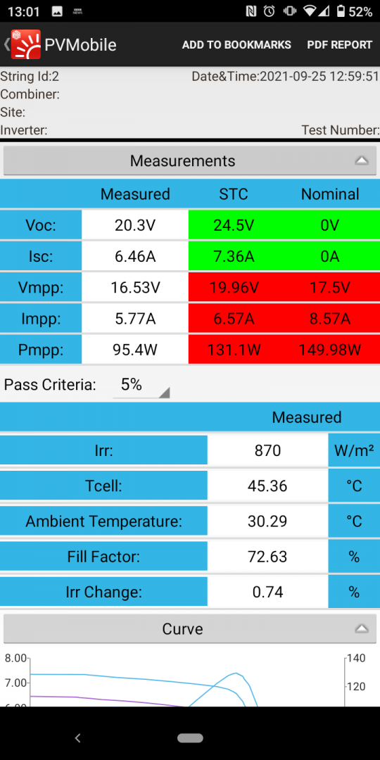

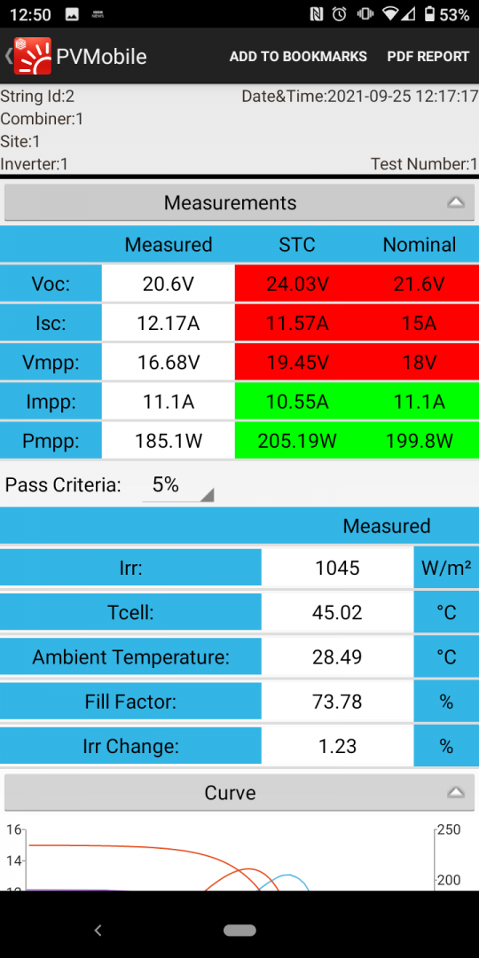

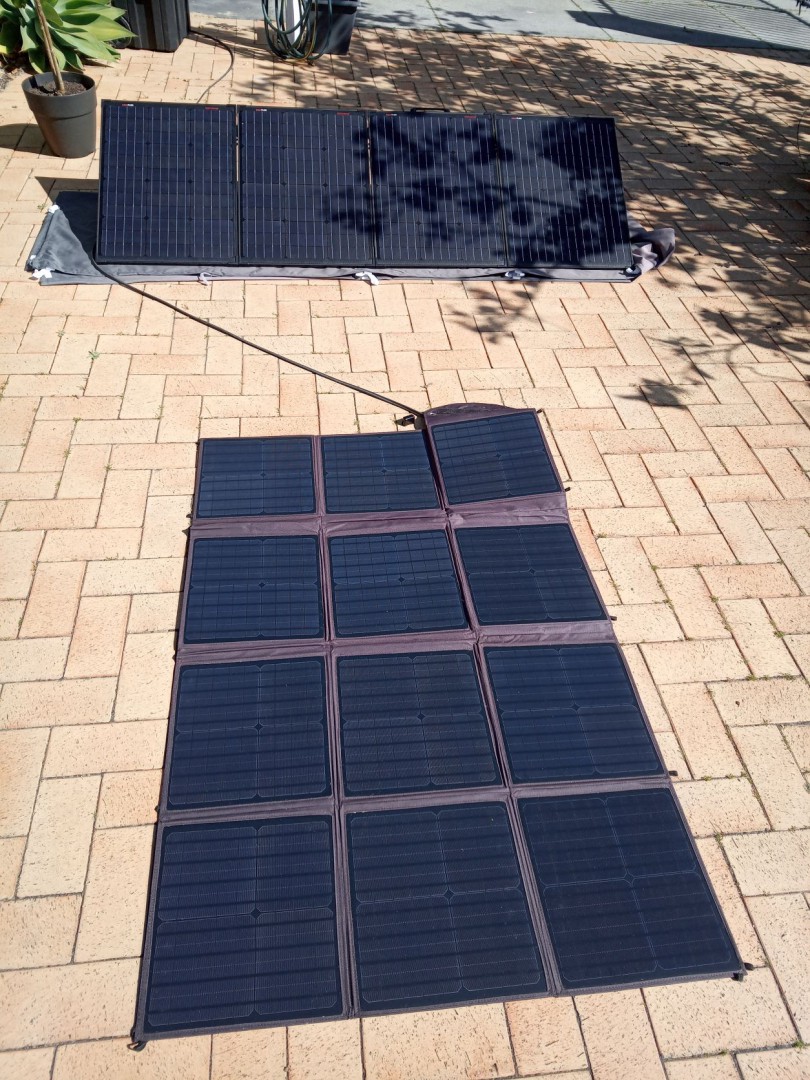

Warren, as to your original question of good or cheap, my view is that both can work for you, just so long as you know what you are getting into with the cheap ones.
For my camper trailer I have both Australian Direct (KickAss) 200W portable panels which cost me $500, and SuperCheap Auto 150W solar blanket which cost $200.
The Australian Direct panels are good build quality, relatively light, use quality materials and have thick wiring and Anderson plugs, but most importantly actually deliver a little more than the advertised output at 205W
The SuperCheap Auto solar blanket uses inferior materials, is relatively heavy, and only delivers 130W versus advertised 150W.
So, you'd think it'd be a no-brainer to go for the more expensive panels? But if you calculate the cost per watt of delivered output, the cheap ones come in at $1.5 per watt whereas the expensive ones are $2.5 per watt, so the cheaper ones are actually much better value. Or looking at it another way, you could buy two of the cheaper panels and get 260W versus 205W, and still save yourself a hundred bucks!
Of course you have to also take into account other factors like weight, longevity, and quality, and that's where the more expensive ones score better, but I wouldn't write off cheap panels as they have their advantages too.
Asutralian Direct 200W folding panels in background, and SuperCheap Auto 150W blanket in foreground:-
Australian Direct panels performance:-
SuperCheap Auto blanket performance:-
