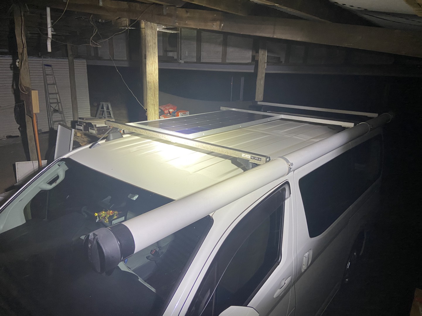

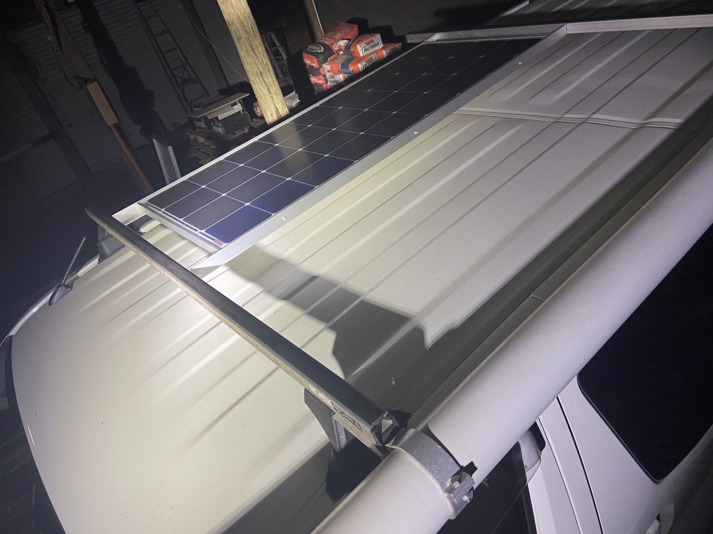

Hi folks, Ive just mounted a Redarc 180w panel on the roof of my new Toyota HiAce.
I installed it last night and drove today with what sounded like a bad French horn player sitting on the roof whenever I got up to about 80kmh !
The din was/is quite horrendous !
The panel itself is 35mm thick and Ive placed it about 90mm behind the Toyota roof bars (40mm thick)
Why did you mount it central inside the two roof bars you ask, Im a ceramic tiler, I cant help it !
Does anyone have suggestions on how to eliminate the howling ? Thinking now that maybe I should just move it toward the front bar? Im hoping someone has had this experience and found the cure to share with me
Any flat straps up there too as they make very loud noises

Can you create a tilt on panel, relative to roof, doesnt need a lot.
09:59 AM Aug 24, 2021
The flat straps are easy to solve. Use the same principle as Burj Khalif 828 metre tall building. If you look at the height of all the sub towers, they spiral in height upward. So the wind spills in one direction upwards.
Put half a twist in flat strap tie downs & they will shut up!
Second issue, if you blow over the end of a tube or two narrow parallel edges you will get a sound. There is a gap between the roof crossbars & the solar panel. You need to make the front edge of the 35mm thick aluminium extrusion, rounded. The same for rear facing edge of the solar panel.
If there are any gaps on the underside of the crossbars, fill them in.
Another option is to put a chevron pattern on the top of the crossbar. This helps spill the air to one side so the air doesn't oscillate.
PS. If you want a quiet van with the bonus of thermal insulation put in acoustic insulation. There is a thread on this in Hints tips and great ideas.

Hi Craig1, I understand you.
I was trying to hide it behind the front bar though, so I can still put things up on the roof racks (the panel sits 3-5mm below the top of the bar, so I can "carefully" still place stuff on the roof)

Hi WAWT, That was why I've used angle to mount the panel on because I knew that tube would want to sing, I'm not overly confident that the angle will last forever, but Ill keep an eye on it for any metal fatigue.
Nice drawing too.

After thinking about my OCD in placing the panel exactly centre between the two roof bars last night, I got my butt into gear this morning and moved the panel forward against the front bar... success !!! I had a nice quiet drive to work today, the french horn player is nothing but a bad memory
Next Tuesday/Wednesday the wiring will be done and I'll have cold water and beers again.
Thanks for your thoughts people.
