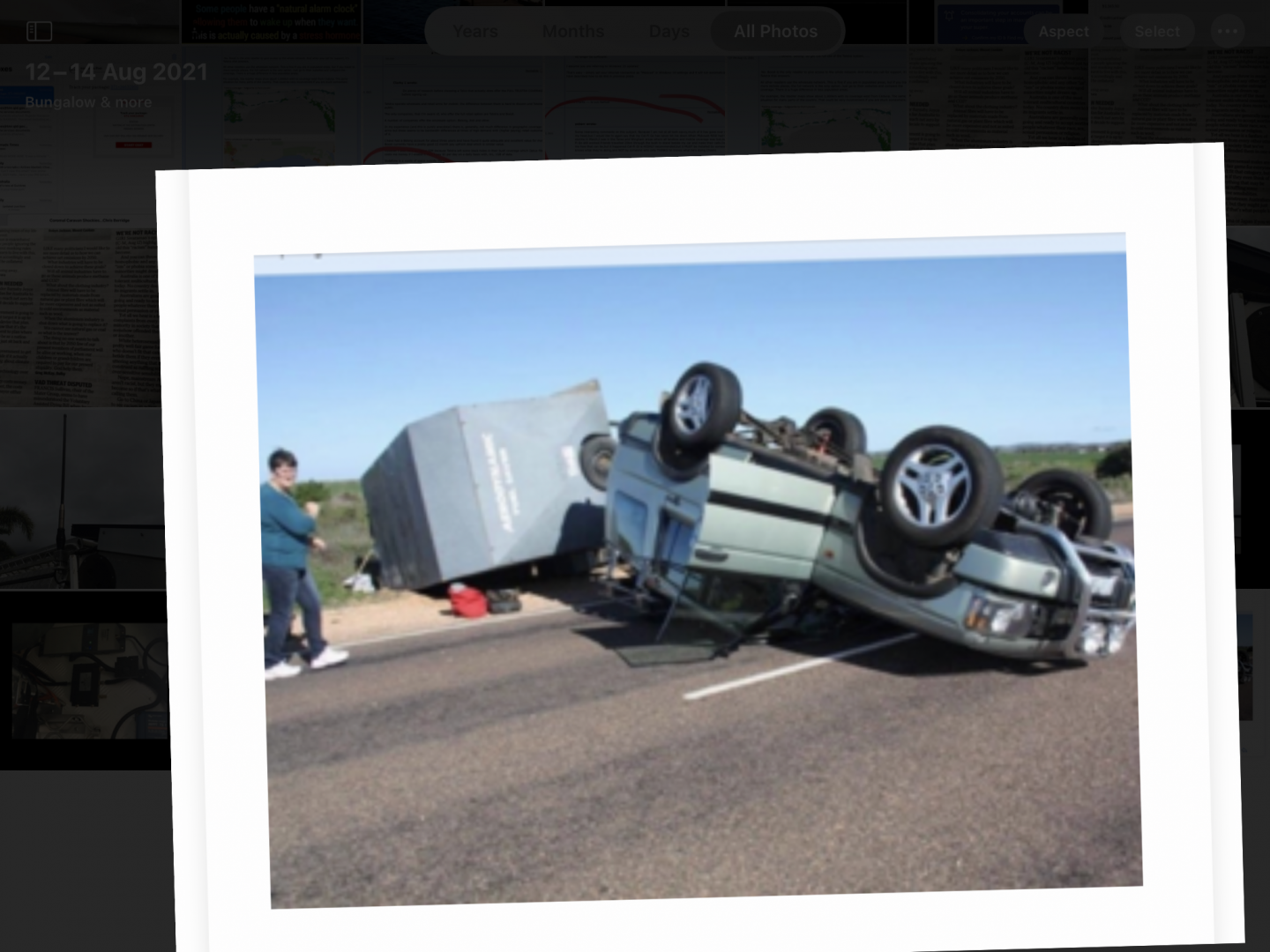

There have been a number of discussions on this forum regarding Rear Axle Weights and ratio of GVM to GTM so I thought I would do some research myself. What I found, quite surprised me. The attached document contains my findings.
