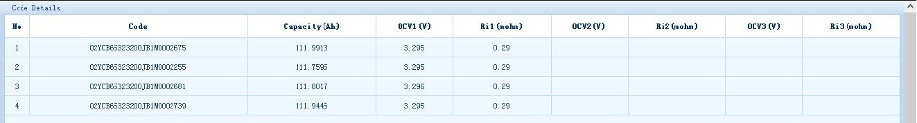

Hi everyone, just to update you on what I've been up to hmm, after looking into the drop in battery replacement market here in Aus I found most of them were just 18650 run in parallel and series, this to me was just asking for trouble in the long term, I watched all of the videos I could find on youtube and read countless posts on DIY forums about assembling my own and decided that this was the best way for me to proceed and get into the lithium battery scene.
I've purchased 4 105ah EVE cells and a 100a BMS from china for a total of $420 AUD delivered to my door. Once they land here I will test them and post my impressions
This is the test data supplied by the company I purchased them from. If all goes well I will then place another order for 8 more cells and 2 BMS's to assemble another 2 batteries and run them all in parallel.
A lot of people are afraid to buy things from China, and rightly so in some cases but if you do your homework and take precautions, then you should feel confident in doing so. I chose a supplier that had lots of good reports of service from people on the DIY forums and also used paypal for the purchase so as to cover my butt if things don't go as planned.

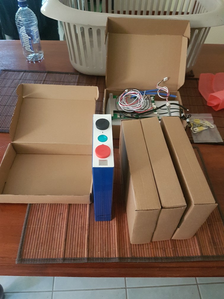

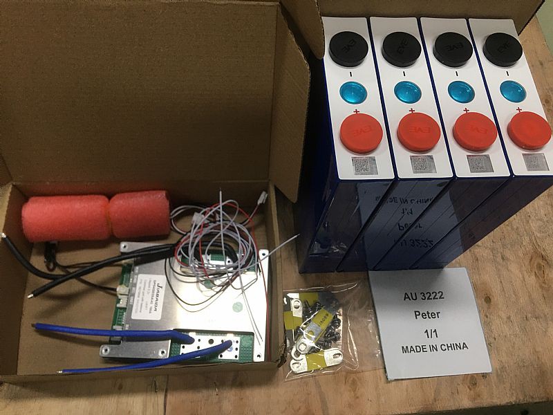

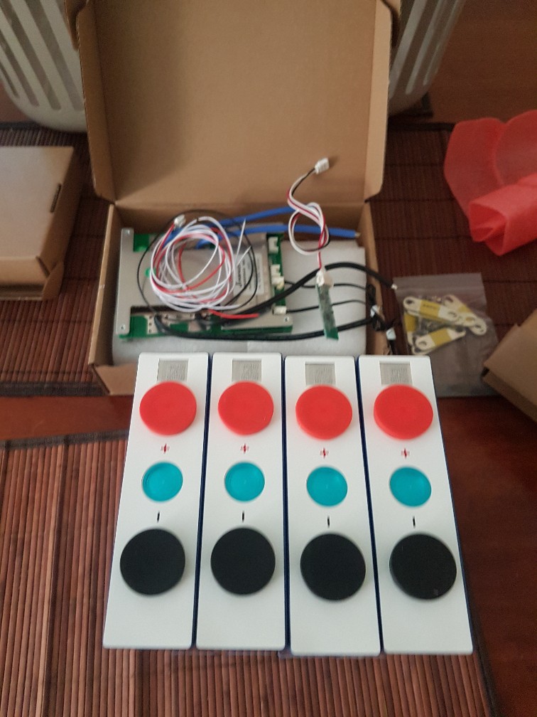

Hi Tim, sorry Iv'e been away and on my return have been busy and this is the first chance I've had to get on here. Yes I was given a tracking Number but it was pretty much useless, however I have had other orders from aliexpress and these also had tracking Numbers, so I just added all these including the battery one to aus post tracking app and the battery parts turned up on that a few days ago but arrived here yesterday only a few days from the min expected delivery date. there have been massive delays in shipping because of covid so don't be surprised if things are a bit slow.
Onto the battery cells YES! they arrived Friday I couldn't wait to start the unpacking and build process lol but only stacked them in parallel to balance for a few hours, then assembled them to charge them ready for testing once my power supply arrives next week.
I was very impressed with the packaging, double boxed then all the parts individually boxed and surrounded in packaging foam.
I haven't added the build photo's as I haven't taken any. Once I receive the power supply I will be assembling it from it's current form to finished state while running capacity tests, at the moment it is assembled and in a battery box just to charge using my solar and a small charger in the back yard lol

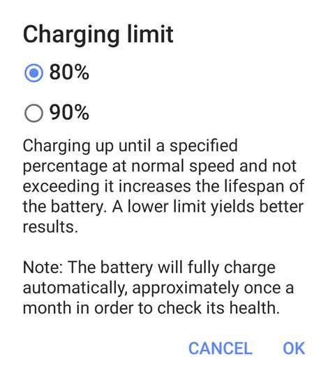

Anyway, I did get a new phone from overseas. One thing I noticed setting up the phone, it asked for maintaining a long battery life, to set the limit of charge to 90% or 80%, so I've set it at 80%.
Your batteries look great peatop, you'll have to give us an update once your setup and running mate
Ha ha that's interesting that it's specified by a phone company but I wonder what type of battery it is and how it's charged Lifepo4 is hard to get an idea on it's charge without using a power meter, can you setup the charge/discharge cycle using one? not sure even the victron can do it, not that I'm going to buy one lol

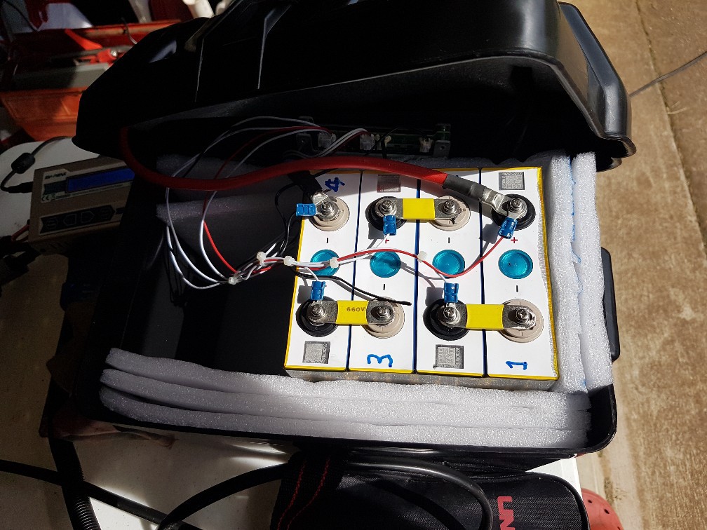

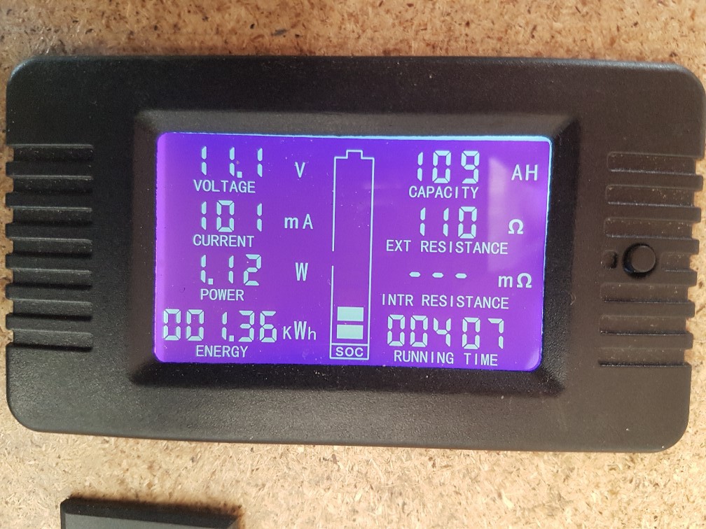

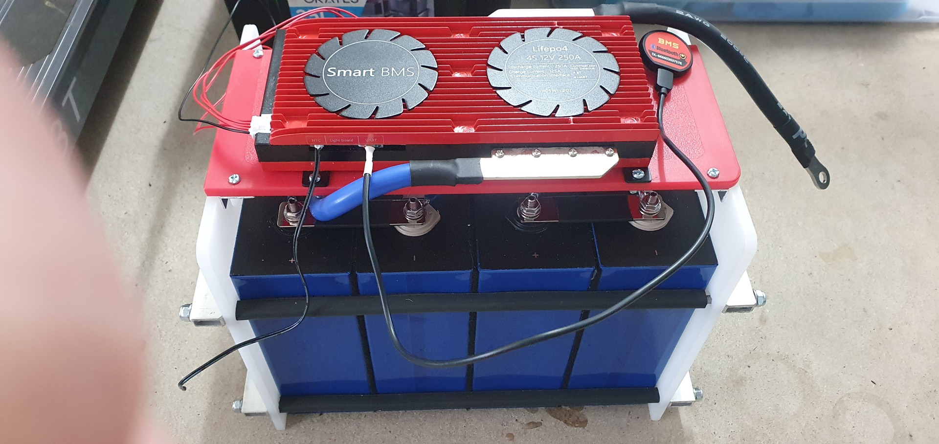

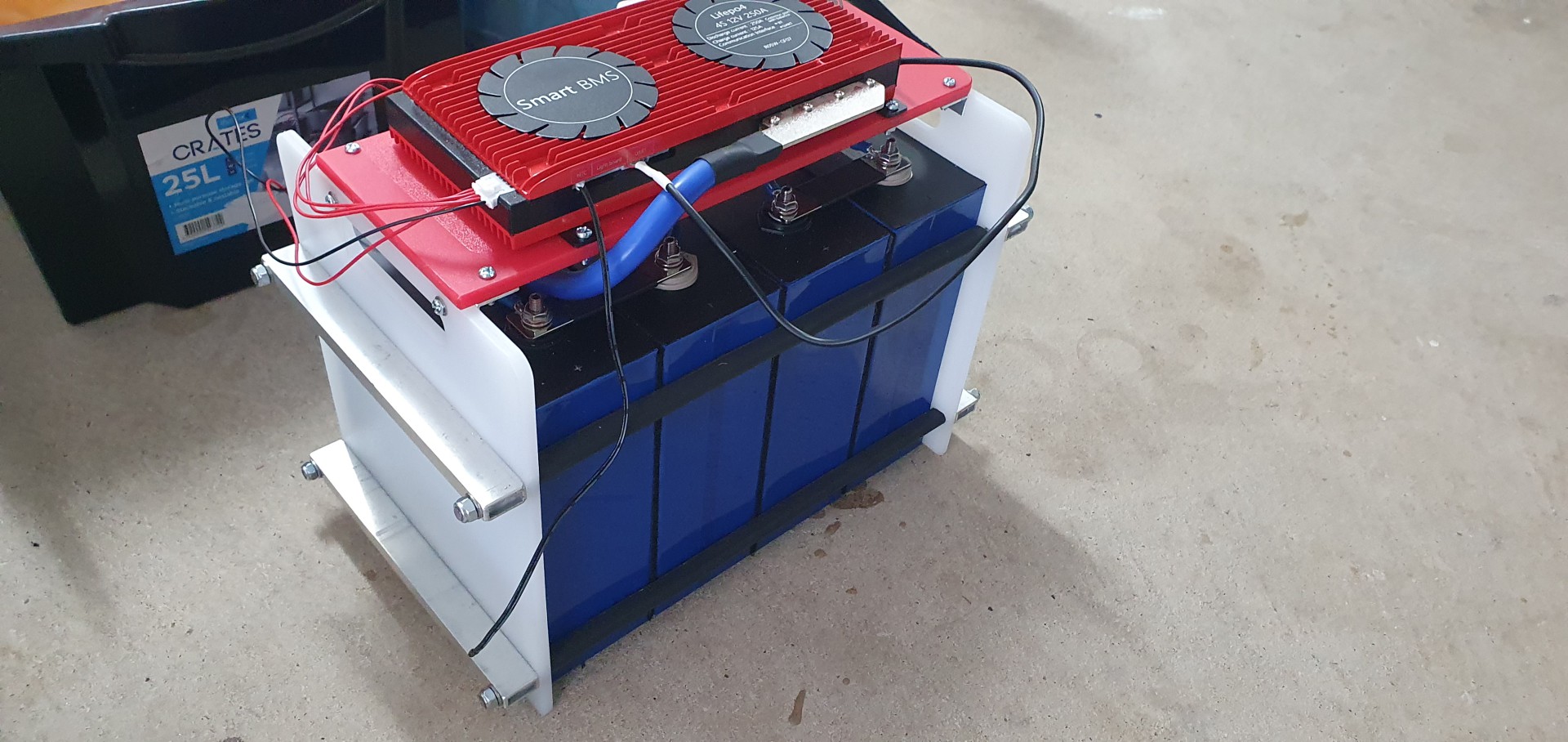

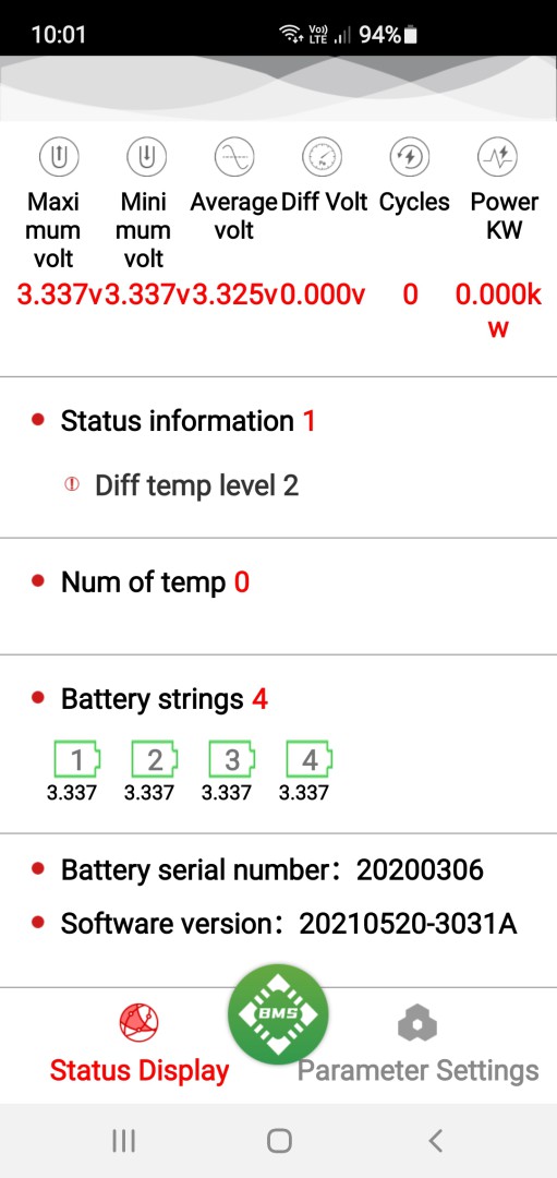

Well today I found my Battery cells well balanced and sitting at 3.5 volt (still waiting on power supply lol) so decided now is a good time to capacity test the battery, using a hairdryer via the inverter I pulled 109 Ah before the inverter shut down, so you could say I'm one happy chappy
As you can see the cells still have a short way to reach 2.5 v
The battery setup in the box but yet to work out the packaging for it

Yeah there's pros and cons to everything, l decided to lightly compress mine with wafer thin foam between them to help isolate the cells from each other as the blue plastic wrap is the only other thing .
Also you don't want the studs getting stressed by movement of any kind , it could cause an electrical nightmare very quickly
Obviously this all counteracts cooling , but I'll be running low c rates most of the time so it'll be ok
I ran studs so l could hold the tension on them with an Allen key while doing up the nuts and touch wood it's been ok , it just doesn't inspire confidence hanging off 6mm x 6mm thread area lol , that's why l recommend the laser welded studs if possible, even then you'd have to be careful not to strip the thread with too much enthusiasm

Kesa32, yeah they do look the part and so small, I bought the smallest battery box and I could easy fit 8 cells and double the amps, which I haven't discounted yet
but I'm still thinking 300 amps total and would prefer they be 3 individual batteries but put in parallel just so I can have one in the car when leaving the camper out bush while fishing or shopping, I will keep this thread updated on whichever way I go but so for so good, the battery is charged and balancing atm and still waiting on the power supply before running capacity tests and final assembly. as a final note though I am tempted to order more right now lol but I'm saving for my fishing trips atm so no spare cash yet
