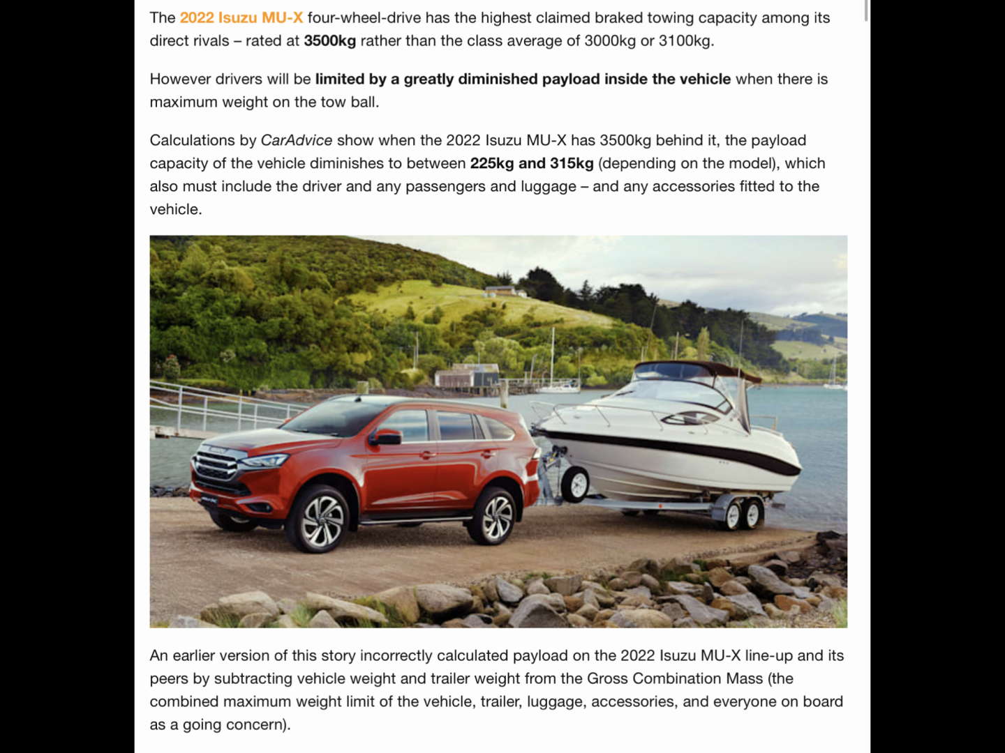

Have seen this before, in a digital mag, put together by a journalist, parts of the data I find to be right but I narrow sighted only check what I need to know.
By the end of August it will be out of date as I am almost sure it is already but the way data is layed out can be updated to help a someone who is the market for a new tow vehicle and looking for information.

Gravy73 wrote:
First time I have seen this data collated.
Hi Graeme. Initially I was going to refrain from commenting on this,but I couldn't help myself,as there is not one vehicle on that list that can safely reach its claimed towing capacity.Not one. There are various reasons for this,but the main one is that the low rear-axle capacity of all of these cars. Providing "information" such as that listed only gives a false sense of security to those who have NO understanding of weights,and encourages recently retired Ma and Pa Kettle,who have never driven anything bigger than a Corolla,to rush out and buy the flash 6000kg GCM twin-cab ute,hook up the flash 3500kg ATM van,and set sail to see the world.This is an accident looking for a place to happen,as always the weight on the wheels of the car should be at least 10% more than the weight on the van's wheels if safety is of any concern.This can never be achieved with tge listed cars if they're towing at their rated maximum.Please note,Graeme,that this is in no way a criticism of you,as your intentions are good,but information such as that provided no doubt contributes to many caravan accidents.Cheers

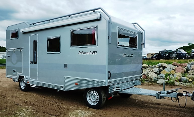

Peter_n_Margaret said
08:11 PM Aug 8, 2021
Ahh but ............. Go to a dog trailer configuration and it all looks very different.
Peter,you are,of course,right.But with many drivers unable to reverse even a PIG trailer,can you imagine the absolute circus if DOG trailers became popular with vanners? Mind you,it would keep cars like Tritons legal,at least.Cheers
