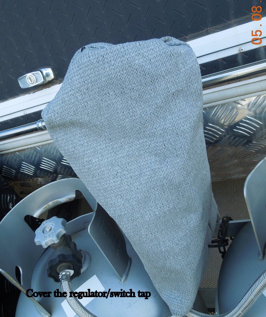

Have read a couple of stories about the tap getting hit and broken by stones, so thought this should lessen any impact, cost maybe 50 cents, didnt stab myself either with the bag needle.
Dick0 said
12:53 PM Aug 6, 2021
The idea of a cover is good.
Also, protecting the gas hoses reduces the internal rubber from perishing.

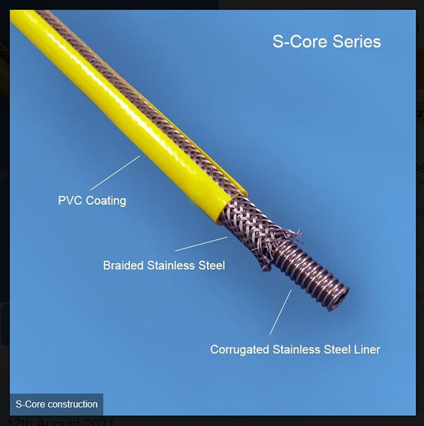

Try going for S-Core hoses. I have attached a link for your reading.
Thanks, but, yellow has been the second worst colour for uv resistance. I have asked the supplier as well, like the other specs though

I cover the front of the van - gas bottles, fuel cans, electrical connections, etc. with a modified tarpaulin when the van is in storage or on site for more than a day or two. This slows down the weathering.
Just a double layer of shade cloth, with a bit of ladder type plastic as a tie
https://www.caravansplus.com.au/guides/how-to-select-the-correct-regulator-gas-hose-a-41.html
I use the S-series pigtail,it has a stainless steel core.
