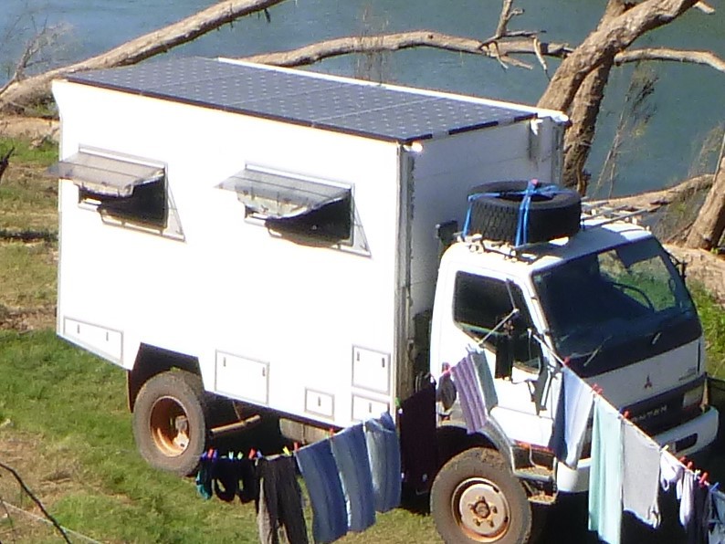

4 full sized panels 350W each on a serious 4WD motorhome. No problems. They are tougher than you think. He used multiple small MPPT controllers (one per panel) for redundancy protection.
