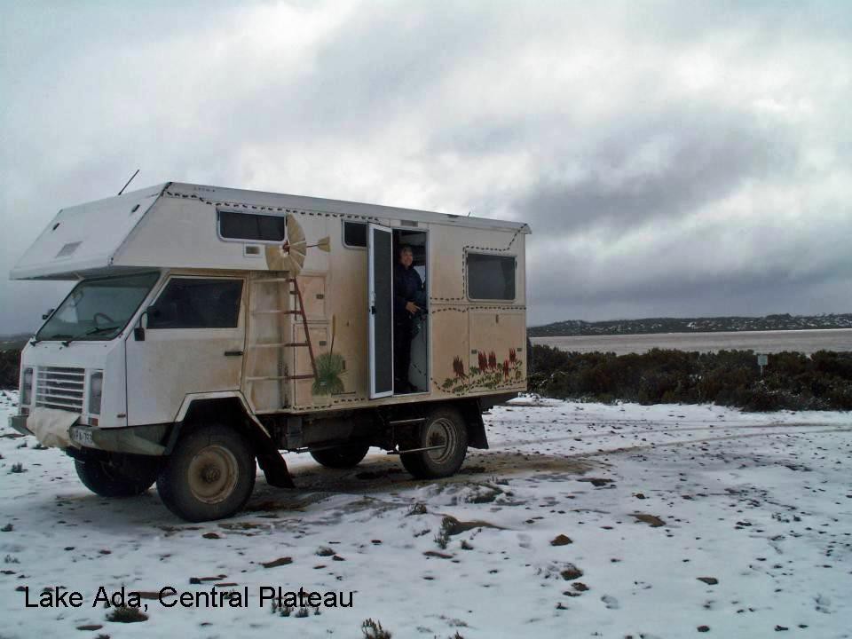

Unless the van is designed with all water inside the insulated "box" of the van like they do in Europe, it is unlikely that you can stop them from freezing easily. However, no damage will be done if the plumbing is John Guest plastic.
Tanks are unlikely to freeze unless you are in sub zero freezing conditions for a whole day and night or more.
Our pipes froze here. It was late morning before we had flowing water.
