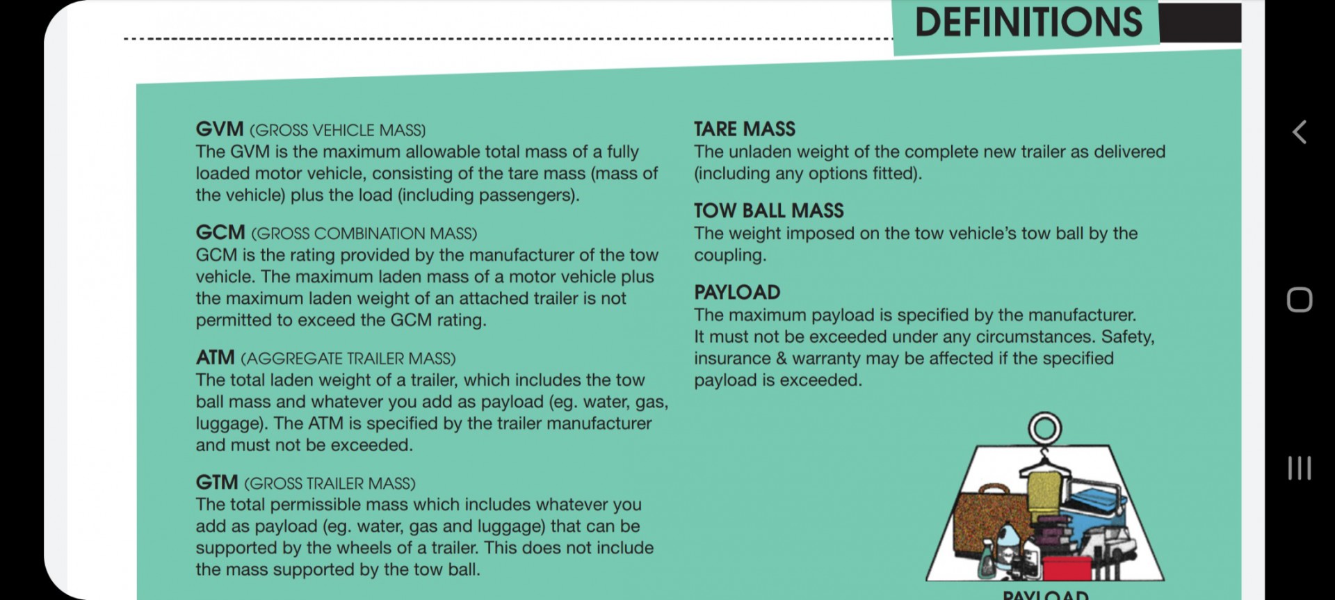

Looking at definitions, the tare weight is the weight of an empty container e.g. a shipping container, but what if one fits a refrigeration unit to that container, then surely the tare weight is now the container plus the refrigeration unit. The tare weight of a caravan is said to be the weight of the van when it leaves the dealer, so ours came with full gas bottles, a TV set under the bed, recliner chairs etc. that's hardly the empty weight. Now just like that shipping container, you have added more permanently fixed items of equipment e.g. solar panels, grey water tank, diesel heater for instance. Then surely the tare weight of a caravan is the weight of the van minus all removable items, regardless of what it says on the compliance plate.
So I intend to get our van weighed, and have removed all the loose items, just need to drain the water, and remove the gas bottles. That will give me the van empty weight and will let me know what weight we have to play with, I intend to do the same with the tow vehicle.
I too have weighed my van and vehicle after taking out everything removable including water and gas but with the vehicle I had full fuel tank. Since diesel weighs 832 grams per litre, I can calculate the empty weight with no fuel. Since Tare already has a definition, I can't say my empty weights are Tare as the purists amongst us would take up arms (and rightfully so). I call my empty van and vehicle weights "Empty weights". Funny about that. Armed with the knowledge of the ratings applied to my rig, I now know exactly what my payloads can be and how it can mixed and shared across the rig combination.
To me, Tare is an irrelevant number and serves no purpose once the van has left the dealer.

Tare Mass is the total mass of the trailer when not carrying any load, but when ready for service, unoccupied (if relevant) and with all fluid reservoirs (if fitted) filled to nominal capacity except for fuel, which shall be 10 litres only, and with all standard equipment and any options fitted. This includes any mass imposed onto the drawing vehicle when the combination vehicle is resting on a horizontal supporting plane. (Fluid reservoirs do not include water tanks and waste water tanks fitted to caravans
The tare weight stamped on the compliance plate is the measured weight of the dry empty van when it leaves the manufacturer and includes all extras fitted at the factory.

Soooooo the empty weight of a caravan complete with all fixed modifications added since the factory roll out would be the revised tare weight, regardless of what the compliance plate reads.

After the caravan has been tared,and leaves the factory,ALL added weight is part of its carrying capacity.There is no such thing as "revised tare". Cheers

The plated tare weight when subtracted from the ATM gives you the van's gross payload.
This gross payload must accommodate water and gas, any after market accessories and all your gear.

IMO unless you have a recent measure, there's no point worrying about Tare Wt. We're legally restricted by actual laden wt. If your ATM is too high then you need a remedy but Tare wt isn't typically a legal or practical barrier. I read a recent thread somewhere that the OP was discussing the Tare Wt of a 10yr van and their first trip.

At the end of the day the only rating that matters is the ATM. Keep your van's measured weight under that and you won't have a problem provided you manage your ball weight. Plated tare assists in the calculation of gross payload at the outset so you can manage ATM.
