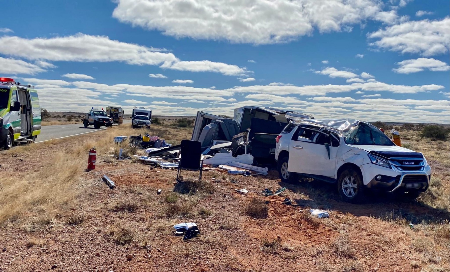

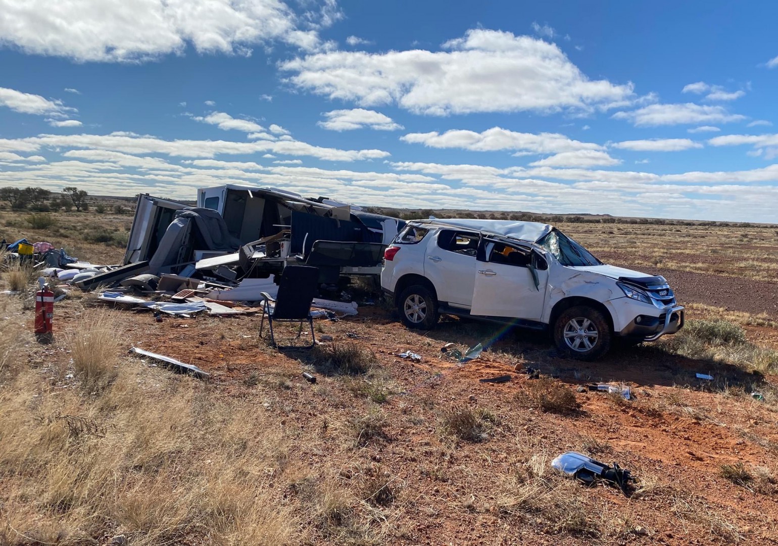

Here are pics courtesy of SAPOL of a caravan and car roll over in SA.
I wonder is the operator of this combination going to be charged with exceeding the towing weight spec of the vehicle.
From what I have read the MUX has a towing limit of 3000 kg and even the shortest Silverline has an ATM of 3145.
Now I am not immediately jumping to conclusions of this traveller being fully loaded in the van so therefor he may be under his Towing weight but the combination would be very close to being on the maximum.
The MUX may have other weight restrictions but in any case if the van would have to be loaded 145kg lighter to weigh 3000kg
It is unfortunate that somewhere a dealer has sold this van to a person who's vehicle is under specification or at the least the owner has changed tow vehicles since purchase or at the very worse, the owner has no idea.
In the police comments attached to this report they suggest that caravan loading needs attention when travelling.
Fortunately there were no serious injuries.

The current Silverline Tourer 21.65 - 3 model has design weights according to Jayco website of Tare 2540kg, load 475kg, ATM thus 3015kg. Looking at the window placement on this van, it could quite possibly be that model.
Still over the MUX figure you quote, but not as far as you suggest may be the case, and careful loading could see the van legal for the MUX, using nearly all of its design rating. Of course that depends on the actual ratings after build and as shown on its VIN plate.
I think any comment re cause is premature and any suggestion of overload unfair on the driver. It is interesting though to see Police are suggesting van loading weights need attention

Hi Ian,
Thank you for those current figures.
I dont know wether you have had access to the report, but in any case the report from the Police were that the driver lost control of his rig while attempting to overtake another van combination.
The other vehicle was not subject to any damage but the SAPOL commentator made mention of how important it is for caravaners to ensure correct loading of their vans.

With a GVM of only 2750kg,there is no way known that an MUX can safely tow 3000kg,in my opinion. The rear axle carrying capacity is a miserable 1600kg,and that axle already carries 1080kg at tare.IF you were silly enough to tow a 3000kg van,the generally accepted 10% towball weight would put around 430kg onto the car's rear axle,so already you are up over 1500kg with no allowance for weight of towbar structure,tools,luggage etc. If safety is of ANY concern,IMO,the maximum weight that that vehicle can safely tow is around 2800kg,so that with 10% ball weight,(280kg) there would be GTM of 2520kg behind a car that MAY,with absolutely fanatical loading,be able to reach its GVM of 2750kg,and thus be around 10% heavier than the van it is towing.In actual fact,that too is impossible,but that's another story altogether! The way that tow ratings for lighter vehicles are calculated is a farce,and the sooner laws are enacted to match those which are in place for vehicles that have a GVM above 4500kg,the better,IMO. For those unfamiliar with those laws,if a vehicle has a GVM over 4500kg,ALWAYS any PIG trailer (caravan) if tows MUST weigh less than the towing vehicle.This minimises the all too common situation of "The tail wagging the dog",and is the reason that many earthmoving contractors have to put a couple of buckets of dirt into the back of their truck when they're towing a PIG trailer that is carrying an excavator,loader or whatever.Cheers

Van/Tug weight ratio is way out here...tail wagging the dog.
A recipe for a rollover.
And no allowance for those reasonably common inclusions called a driver and passengers! In my experience to date, even many of those smart enough to monitor ATM, GTM, TBM, GVM and tow capacity completely miss the rear axle loading, which seems to be the factor more at risk of breach than anything else when towing a two ton plus van. Perhaps a three letter abbreviation is needed to grab peoples attention, I proffer RAL!!!
