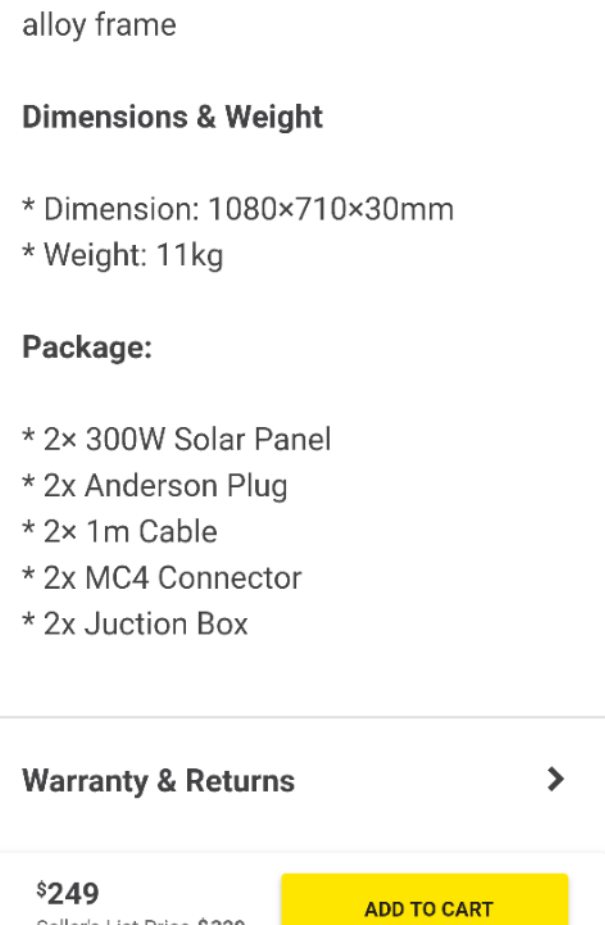

2 x 300 watt panels packaged size 1.080 x 0.710 = 0.767 square metres.
300 watts ÷ 0.767 = 391 watts per square metre!
I have done some back of the envelope figures for you. I will leave it to others to add their comments!

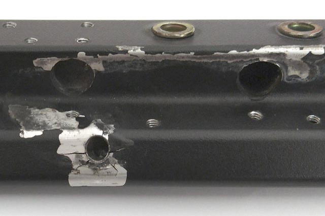

This is a poorly designed roof rack rail & stress cracking can be seen around the bolt hole.

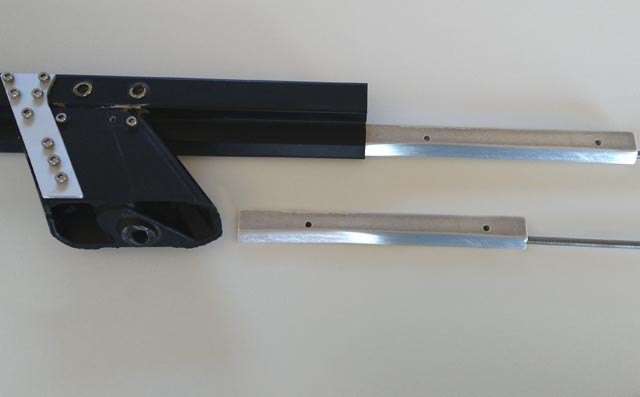

To remedy this problem I made a long section of 5083 structural aluminium to bolt into & spread the load. Additionally I have added a plate holding the rail section & leg together. So all up 12 bolts are tapped into the 5083 section or bolted through as many places as possible to spread loads.

Ypu can't just go screwing solar panels to the roof. Putting leaks aside. The problem is surface area. Even if you use a few screws for each corner of the solar panel. They simply do not have enough surface area. They are simply hanging on by a thread.
Every time the vehicle goes over a bump there will be a lot of stress on the vehicle. It will end up cracking the body panel.
Screws will pull out & panels will fly off, hopefully not killing someone in the process, or into a following car's windscreen.
Every screw hole will become a stress fracture point & rust will set in & be an absolute nightmare to fix.
If you do not want to bond the panels to the roof. You need to bolt them to a roof rack or roof platform which in turn is bolted or clamped to the correct spots on the vehicle so you do not get stress cracking of the bodywork.
This is why you bond panels onto the roof to spread the load as much as possible.
& a reminder when bonding the fitting to the roof it takes about 25 days for the Sikaflex to cure. It cures with air, but it takes about 1 day per 1mm width of pad.
So in other words. If the pad is 50mm wide, it will cure from both sides. So 25mm from one side & 25mm from the other side. So 25 days in total.

I bought some solar panels with over stated performance claims from Kogan.
They eventually gave me a 40% refund.
I'm currently in the process of upgrading my solar and need a couple of panels around 100W/120W. After extensive searching on-line and doing panel area calculations I decided I could not trust most of the suppliers! Quite a few, it appears to me, simply lie about the capability of their panels.
I have decided to buy a couple of 115W Victron panels because I feel confident a company with a quality reputation will not intentionally lie, they may "massage" the truth :) but I suspect I will get, more or less, what I pay for.
Incidentally: as best I can tell solar blankets are appallingly overrated for output power.
You have hit the nail on the head. Quality is cheaper in the long run.
I would have bought Victron panels. By the time you amortize a product over 10 years there is barely any difference in price.
I needed a size oanel that would fit a space. I bought Projecta 20 watt panels. They are very conservative in their watts per square metre rating at 113w/m˛ at their rated output for the overall panel size, but they have performed over specification easily. Together with very heavy wiring & a Victron controller I easily get 9.8amps into the battery with up to 11.3amps out of 120 watts of panels.
Why put on a 2 x 300watt no name brand that can't light a fart.
