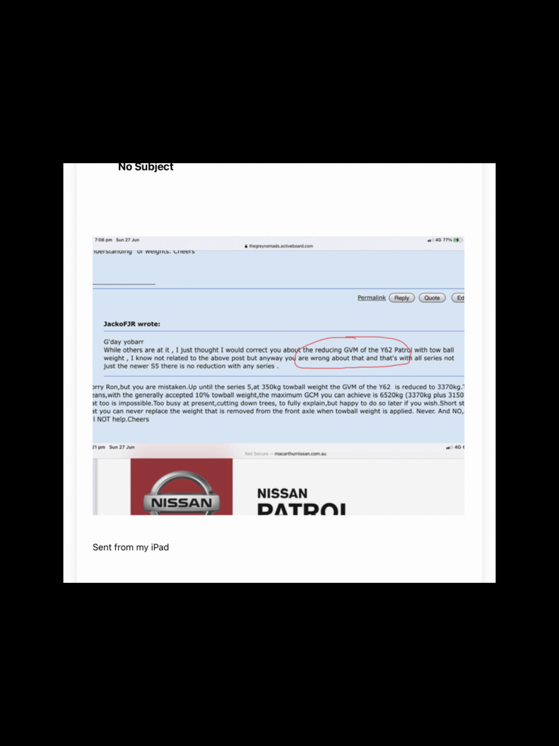

While others are at it , I just thought I would correct you about the reducing GVM of the Y62 Patrol with tow ball weight , I know not related to the above post but anyway you are wrong about that and that's with all series not just the newer S5 there is no reduction with any series .

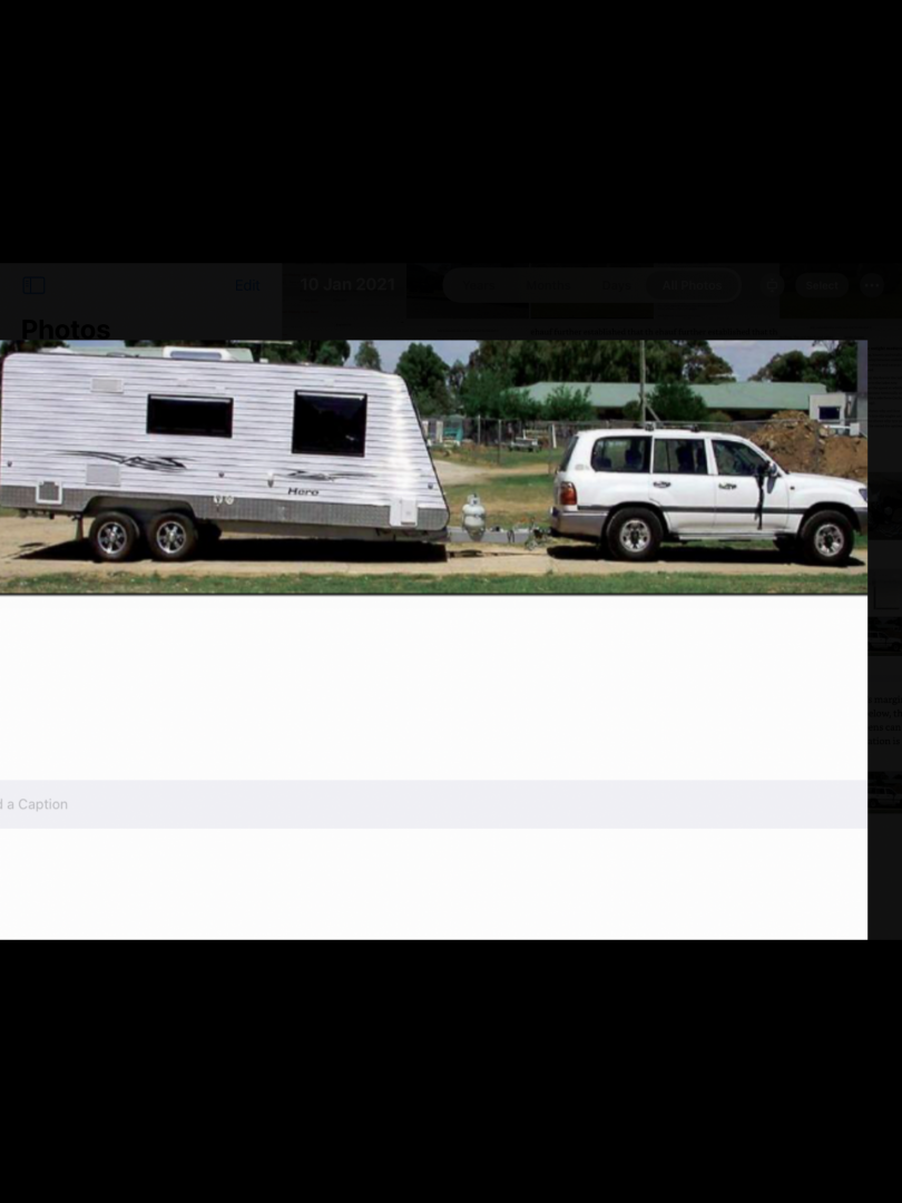

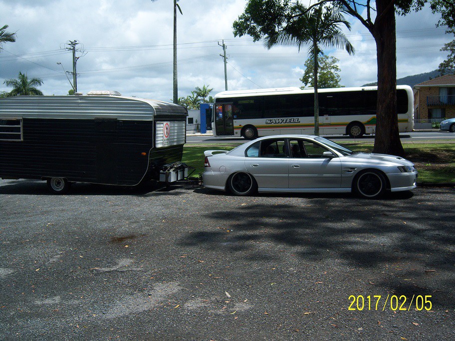

My thoughts on the posted pictures other than the ridiculous VW one are as follows.
79 series is probably overweight but I would say his hitch height is not ideal and why he has a WDH on in the first place when it is so poorly adjusted I doubt it is having much effect. It is right at the end of the chain and it doesn't appear to have much in the way of tension on it.
The LC200 could well be within weight limits but again the hitch height could be much better than having the van doing such a nose dive.
The Commodore has been fitted with lowered springs and they were always a bit soft in the back end so really no suprise there. Unless he has an enormous amount of gear on board, with that little Millard van the Commodore under normal circumstances should tow it quite comfortably, but if you are going to lower it then this is the end result.

G'day yobarr While others are at it , I just thought I would correct you about the reducing GVM of the Y62 Patrol with tow ball weight , I know not related to the above post but anyway you are wrong about that and that's with all series not just the newer S5 there is no reduction with any series .

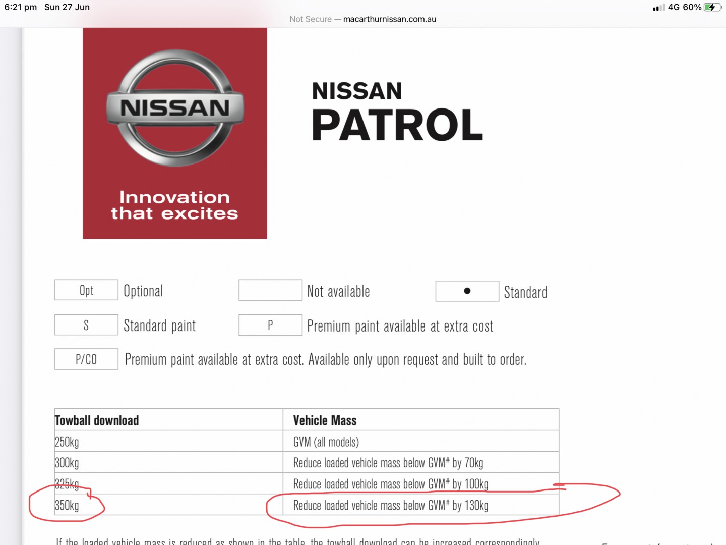

Sorry Ron,but you are mistaken.Up until the series 5,at 350kg towball weight the GVM of the Y62 is reduced to 3370kg.This means,with the generally accepted 10% towball weight,the maximum GCM you can achieve is 6520kg (3370kg plus 3150kg),but that too is impossible.Too busy at present,cutting down trees, to fully explain,but happy to do so later if you wish.Short story is that you can never replace the weight that is removed from the front axle when towball weight is applied. Never. And NO,a WDH will NOT help.Cheers

Greg, I think the vehicle in the third pic that yobarr posted is a 100 series and not the 200.

Sorry Ron,but you are mistaken.Up until the series 5,at 350kg towball weight the GVM of the Y62 is reduced to 3370kg.This means,with the generally accepted 10% towball weight,the maximum GCM you can achieve is 6520kg (3370kg plus 3150kg),but that too is impossible.Too busy at present,cutting down trees, to fully explain,but hI know all that appy to do so later if you wish.Short story is that you can never replace the weight that is removed from the front axle when towball weight is applied. Never. And NO,a WDH will NOT help.Cheer s
Yes yobarr I know all that . I do own a S4 Y62 Patrol with that sticker and only tow a camper and would never try and tow 3.5T anything behind it . But that topic used to come up all the time on the Y62 FB page . A member a few months ago emailed Nissan Tech department and got a reply that he posted , I wish I had of saved it , on every series Y62 you can legally have a 350Kg tow ball down load but you must not exceed the GVM of 3.5T or the max rear axle load of 2030Kg . That sticker in my door clearly says " GUIDE ONLY " it doesn't say anywhere you must reduce the amount xyz
The suspension of the Series 5 Y62 is exactly the same as all other Y62's except for the first Series 1, STL , even some of the very first Series 5 Y62's had that sticker . Nissan removed that sticker I think because of all the confusion it caused but Nissan still like to confuse people by saying the Y62 has a GCM of 7T , you and I both know that's just not possible but you might be surprised by the amount of Y62 owners that just cant get their head around it , they honestly believe they have a GCM of 7T . Toyota do the same with the 200 Series just add the Max GVM of 3350Kg and Max Towing of 3500Kg and say it has a GCM of 6850Kg . I have never seen a Caravan with zero ball weight , even a Dog trailer would have some ball weight . I have 2 VicRoads weigh bridges very close to me that I can use anytime I like and I have many times , I even weighed the Dealers Demo S3 Y62 before I decided to buy one . I'm very aware of how much weight is removed from the front axle when weight is applied to the tow ball and yes you can never replace it .
It really doesn't matter to me , like I said I only tow a Camper Trailer less than 1.5T with a TBW of 160 - 180kg and that reduces the front axle weight by about 70kg .

Unfortunately yobarr just assumes that most of us are overloaded or that none of us know what we are talking about.
He continually assumes that we all have a ball weight of 350 kg and this is easily confirmed by reading back through his posts.
I agree that some of his pics may be indicating a weight problem but he doesn't know and neither does anyone who does not actually own and operate these combinations. Some of them could be something as simple as an incorrect hitch height.

The Plain Truth is that the answer to your question,along with my explanation, is clearly shown in my post,in this thread,from June 26,at 5.21pm. Had you taken the time to actually read all the posts,rather than simply look at them,you may not have felt the need to submit the above question? I sincerely hope that this puts your mind at ease.Cheers

Regarding the van and tow vehicle above. You do need to be carefully before jumping to conclusions. If you look closely it looks overloaded for a reason. The tow ball is too low. But if you look closely the rear guard is only about 1 inch lower than the front. So poorly set up, yes, over loaded,,,perhaps not very much at all.
Surely you jest? The towball is too low because the van has too much ball weight,and has forced the rear of the car to drop dramatically. If you look closely you will see that the sill of the car is at quite an angle to the road surface. (Shadows) You suggest that the rear guard is only about 1 inch lower than the front? The only way that may be correct is if your inches are far greater than mine? Looking at the distance between the tops of the tyres,and the wheel arch on the van, seems to me that,for some reason,that van has been raised a long way? Strange.Cheers
