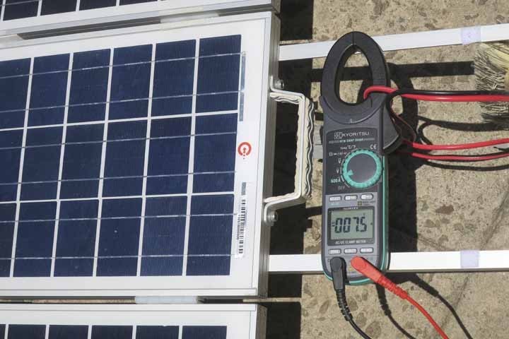

Ideally they show be wired in, in such a fashion that you can measure each one individually, this could be wired in with individual switching. A DC clampmeter is a great tool to check everything.
I would measure the size of them and just look on the web for similar sized panels to get some idea of the power. Sometimes you might get a mobile to take a pic of the specs label by sliding it under.
If you want to know if one is not working then assuming you have an indication of the power or amps of them all, get out in the bright high sun, cover the panels with thick blankets or similar, and uncover one at a time and see how they compare. Do not fall off the ladder though.
Obviously a clamp meter would be easier but only if the person who wired it left the wires available to get around individually and I have not seem that often.

Covering or clamp meter or disconnecting one at a time is the only way to get a reasonable actual.
