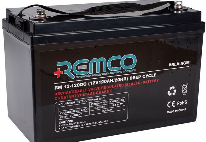

I also have 2 x 120ah AGM batteries (Remco) and the Prostar controller as in the photo by Aus-Kiwi above. My query is what setting should the battery type be on ? ie 1,2 or 3 in the photo above. I have previously asked this question with varied responses. It has been set on 3 (Flooded) for a year now and seems to be working fine, however due to past varied responses I am never sure ? cheers

Hi KM
Well I might think it is clear that they are sealed AGM batteries so 2 is the right selection IMHO.

Is it like this one ?
